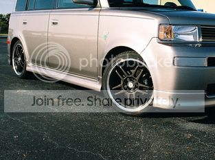

That's my exact setup. I went with the Teins because i didn't want to go crazy low (wife drives it too) but I wanted better handling and stability, plus help with the dreaded wheel gap.
The interesting thing about these is that they feel more compliant and way less bouncy over typical road irregularities, but firm up in a big way when loaded with lateral (cornering) G's. That's because they and other aftermarket springs are progressive rate, versus the linear rate OEM springs that tend to bounce all over the place all the time. I am very happy with the S-Techs. Here's a few pix:
After these tires wear out I'm going to try 215/40 or 215/45 tires for a slightly cushier ride, and to fill the wheel wells even more.

hey professor xb here's my tein s-tech's with 17" professor sp1's +30 offset.
