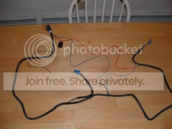

Hi All, I am ashamed this has to be my first post ever...but I asked for fog lights for my 2005 xB for X-mas. Guess what...yup I got them but my little sister brought them from Atomic Street Team Ebay store...
and there is no instructions and they wiring is not even close to the Stock Scion Fog lights. the only thing similar is that they will fit into the slots other than that I don't have a clue where to start.
Can any one please help me.
Of course as most auto ebay items there is no returns and they are not responding back to my email questions asking what color wires are what. I am stuck in between a rock and a hard place.
Any suggestions. Many thanks Garrett

some pic of the stuff you do have mite hepl us help you.

I just posted three pictures of the light kit to my gallery. Thank you so much for your help

#1 most of us use photobucket.com to post pics, its real simple
heres you pics

i got these same foglights, they are a pain in the azz to install, but i was able to get them up and running. i have no idea what the second wirring harnes is, i dont think you need it. the xb is already pre wired for the fog lights. more than likely you will need new plastic plugs that fit on the back of the lights(wich allow you to put them into the bumber cutout) you will also probably need a relay, i can find you the part numbers on these. you can get a relay from autozone for 20bucks, and those plugs i was talking about are like a 1.25 from the dealership. dude, i live in toledo too.

Step by Step JDM install, courtesy of xbsite.com
http://www.xbsite.com/forum/jdm-fogl...all-t-261.html

if you do need the relay,i got this one from autozone, its a direct fit, GP Sorensen part number is 41-5154. if you go to autozone and ask for the toyota relay, they have to order it and they charge you like 50-60 dollars, this one is 21 dollars

Thank you so much for your help...the puzzle is getting closer to completion.
Things I think I need to buy...
1. New spacer brackets for the fog lights
2. New wiring connector for my on/off switch
The kit did come with an automotive relay (YL-388-S) 12v/40A, form looking over the link that was posted for JDM Fog Install...it seems to me that this relay might just work.
This is another guide that I have been looking at online http://www.trdsparks.com/install/08590-52820inst.pdf
Leov36- Again many thanks for the help...I am from Toledo, but am currently living and working in Vermont. There is zero automotive clubs/stores/resources were I live so Scionlife is totally my life line.
