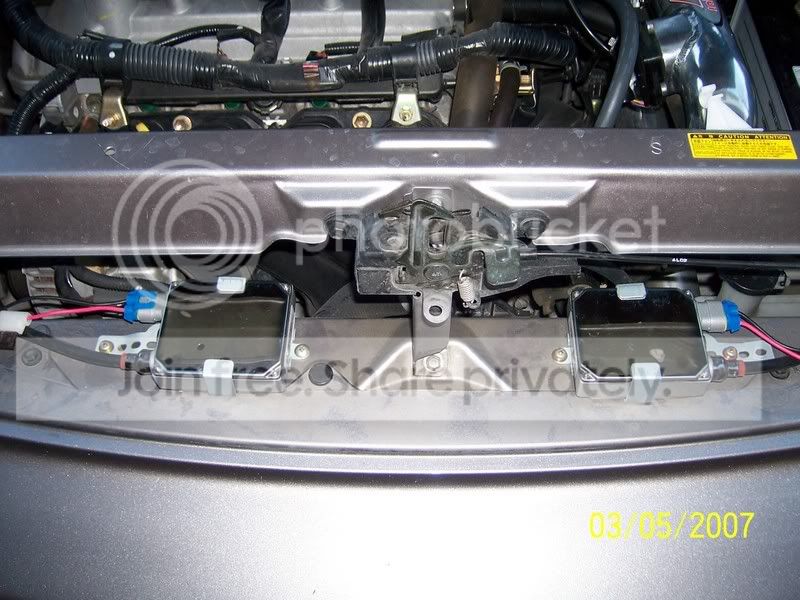

i am wanting to get a set of HIDs for my fogs and i dont know how i am going to do that, number one, where are the two extra ballasts going to go...number 2 does this mean i am going to have to install another wiring harness and relay for the second set of HIDs...if you have 2 sets of HIDS in your box tell me what you did and if you can let me get an engine bay picture so i can see where you mounted everything and ran all the wires...please...please...please...please...please...please...

I just have them in my fogs and are pretty bright!
here is the ballasts!
and the wiring!
and all together!

what about the wiring harness, will i need two of them also, i am not about to fry my electrical by just doing the "plug and play" way, i was just wondering if there was a way i could splice into the harness i already have, and CREEPINGONCHROME, thats a really good place to mount the ballasts, i really never thought of putting them there, i have mine on my strut towers and there is no room for another set...
