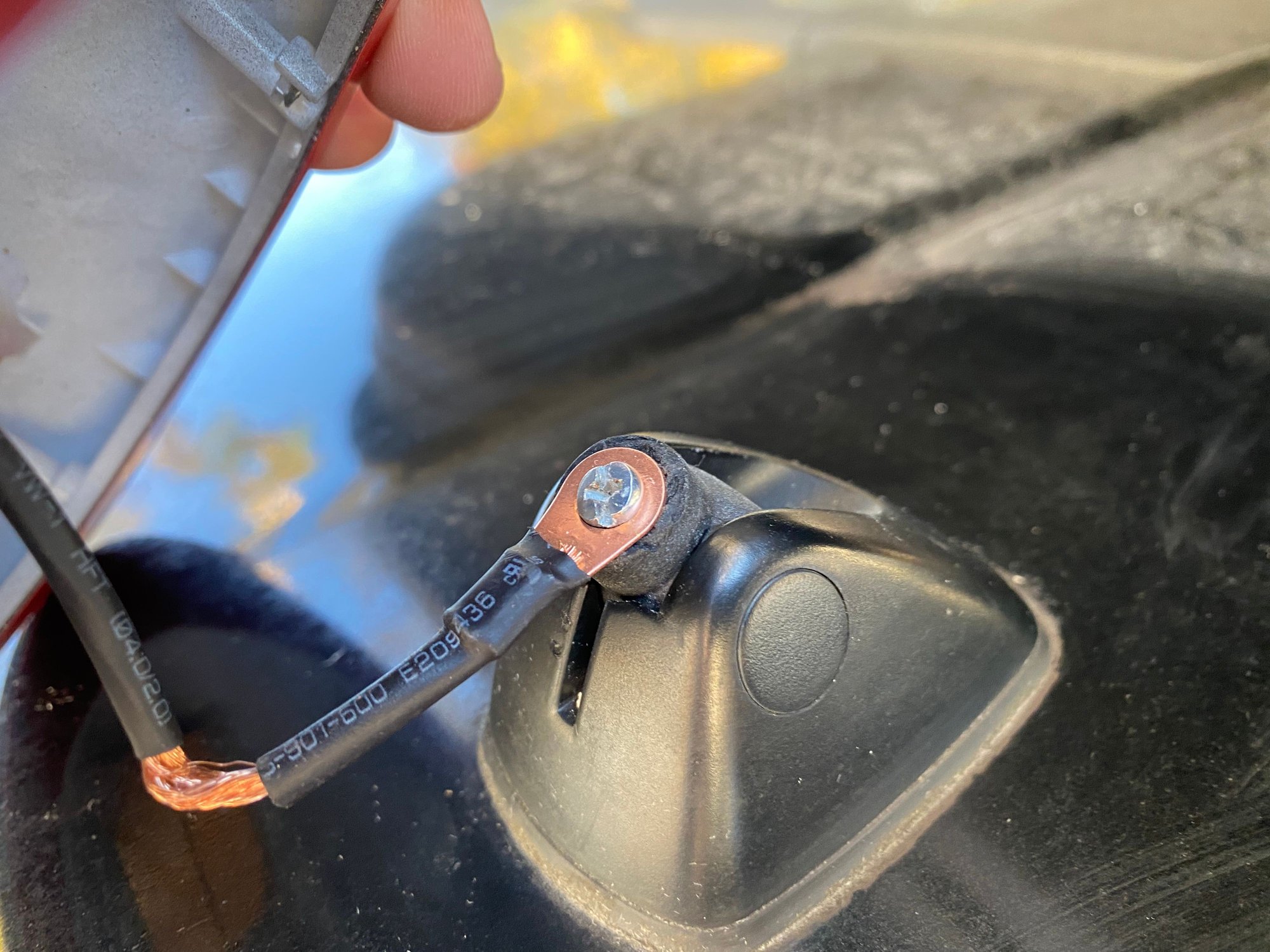

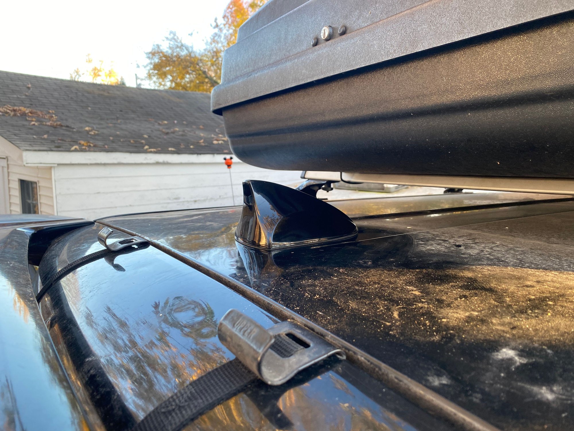

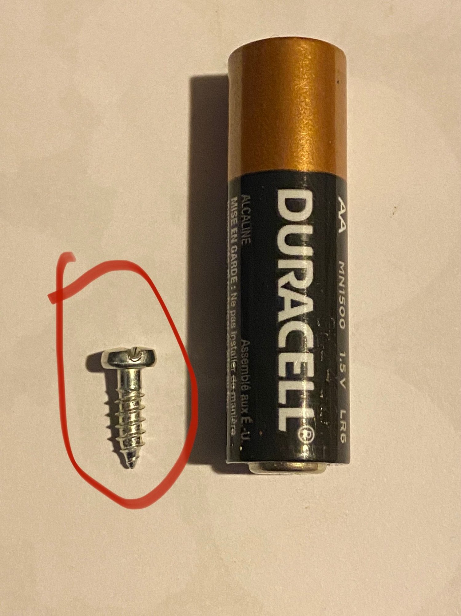

Ok guys! So I did it! I took a little sheet metal screw and screwed it into the little circle hole into the plastic (red circle in pic) and made a nice tight fit. Then I put the new $25 shark fin from Amazon on and now I have great signal now! See pics.

Excellent. Nice Job!!
