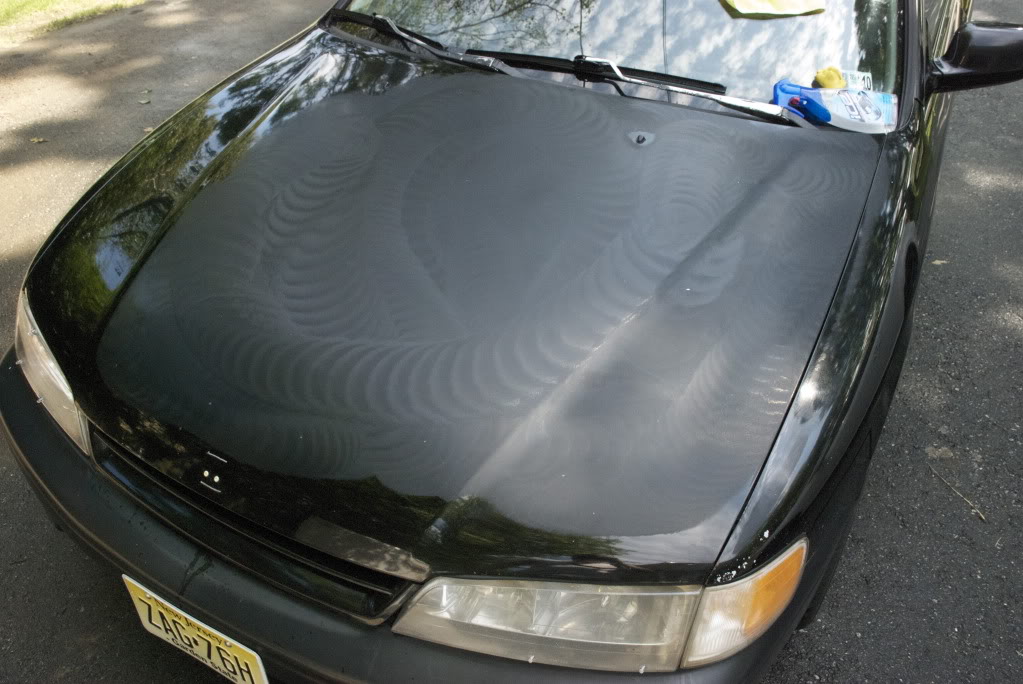

After wash, before clay/cleaner/polish/wax (wet on left)

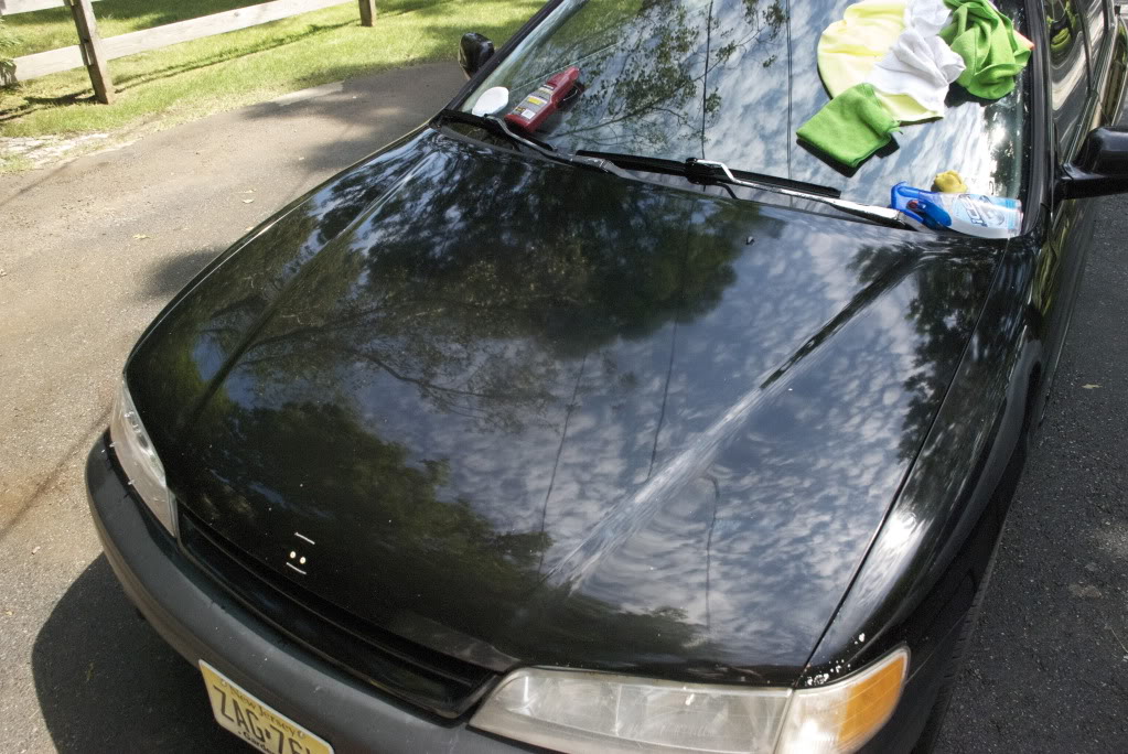

After clay/cleaner, polish applied (did a pretty big area)
After cleaner/polish/wax

Originally Posted by CarbonXe
Also since you seem to know what you're talking about. I've managed to restore some color in the hood of my 95 Accord, but there is still a very noticeable blemish. Any recommendations on how to restore the color? I've tried polish, meguiars ColorX (seemed to work the best out of everything), etc.
Got a picture?

Originally Posted by seppuku27
Got a picture?
Look up at the first picture. Left side is dry, before any kind of restoring work. Dull color, blemishes, swirls. I got it pretty shiny, but the blemish is still there in the middle of the hood. I'm probably going need a deep cut compound, right? The only cutting I did, was with the Meguiars swirl remover, which I kind of just wanted to try it out. It was only a 3/10 on Meguiars cutting rating, so I knew it wasn't going to be a deep cut.
How were you working it, by hand or DA? I would get some ScrachX 2.0 and use an orange Lake country pad if your using a DA. Be sure to work a small area at a time like a foot by a foot. Honda paint usually is pretty soft so you really don't need a compound for it.
I was using an orbital buffer. I tried ScratchX, didn't do anything for me. It works great on my tC for small scratchs and scuffs, but doesn't do anything for the swirls/oxidation on the hood.
I don't think I need something as strong as 105. I was thinking of trying out the heavy cut cleaner.
Also, to clarify that I'm doing things in the right order...Wash, clay, paint cleaner (in this case, the heavy cut cleaner, M4), polish, wax...right?
you got the steps right..I wish I could lend you my bottle of M105...I swear it is that worth it.
The problem is the orbital buffer. It simply doesn't have the power to remove defects. Look into buying either the Flex, G110 or PC 7424XP and some lake country pads. Its the best investment you could make to keep your car looking good.
Remember try the lightest polish then work your way up to a more aggressive polish if need be. Just don't start out with something like M105.
