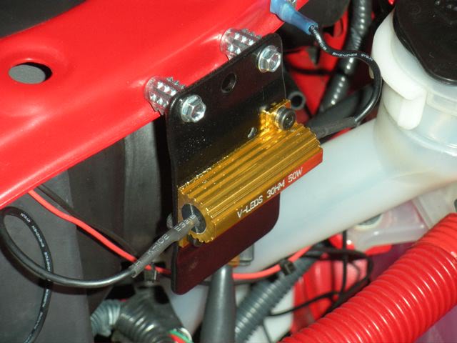

hey I have these same ones just sitting there have not gotten around to installing them....anyway you can post pictures of the wiring job and location you installed the plates on? along with one of how they look...thanks

Here is a picture of my Load Resistors mounted on heatsinks (Painted Black) and mounted behind the headlights .
Sorry I am a lil late on responding...havent been on much...thanks for the pictures much obliged my friend!!! helps make my install much easier!
Thats a very clean installation
