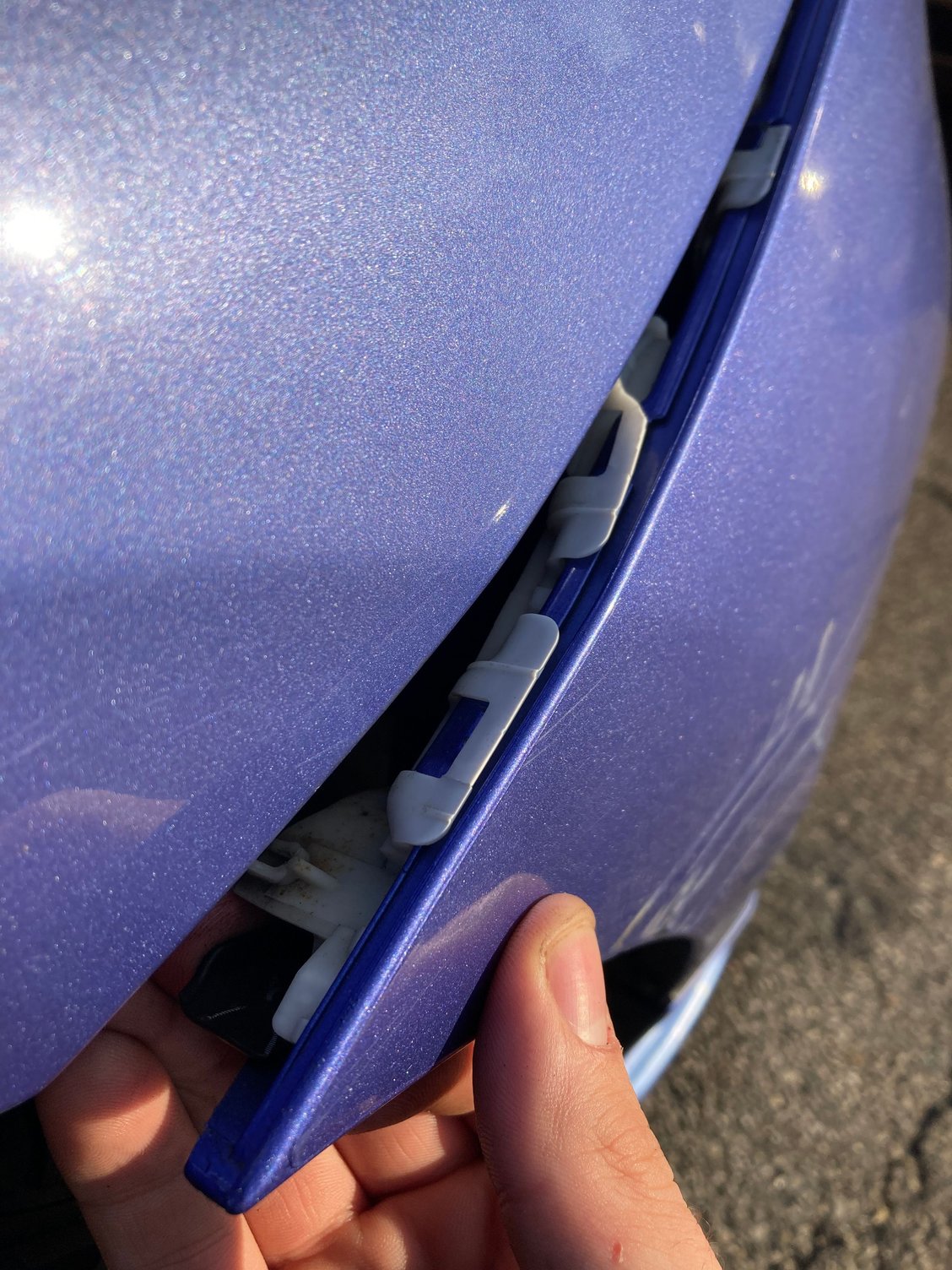

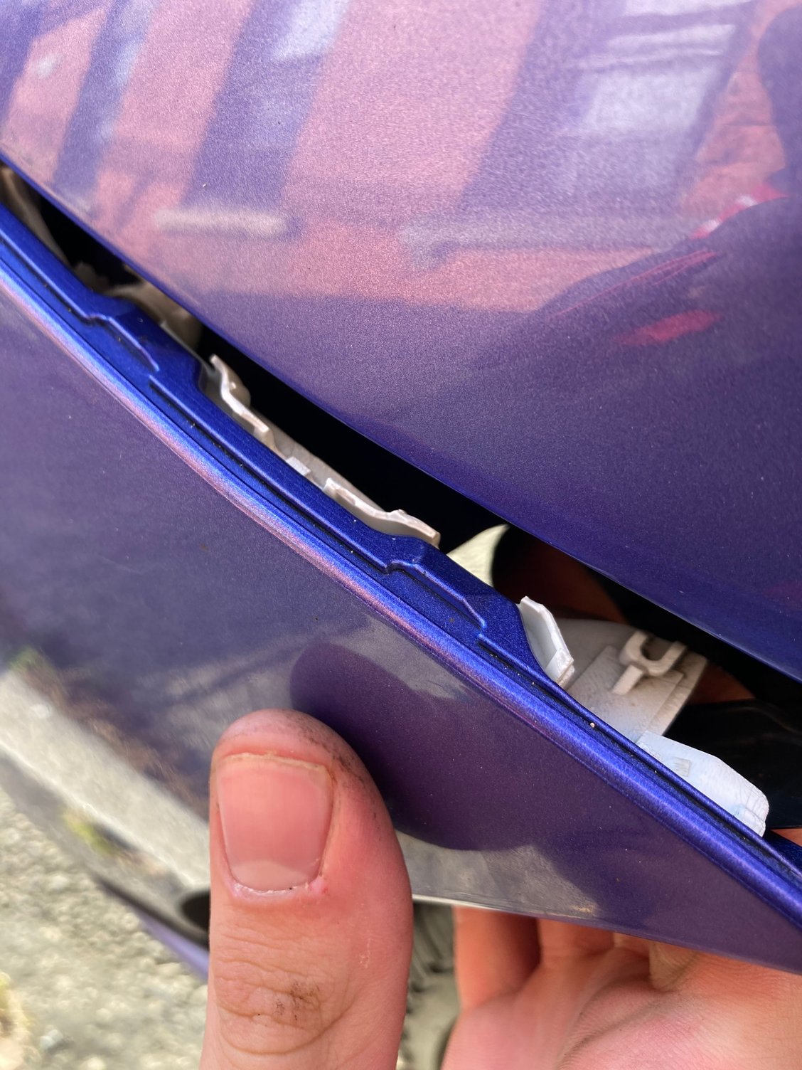

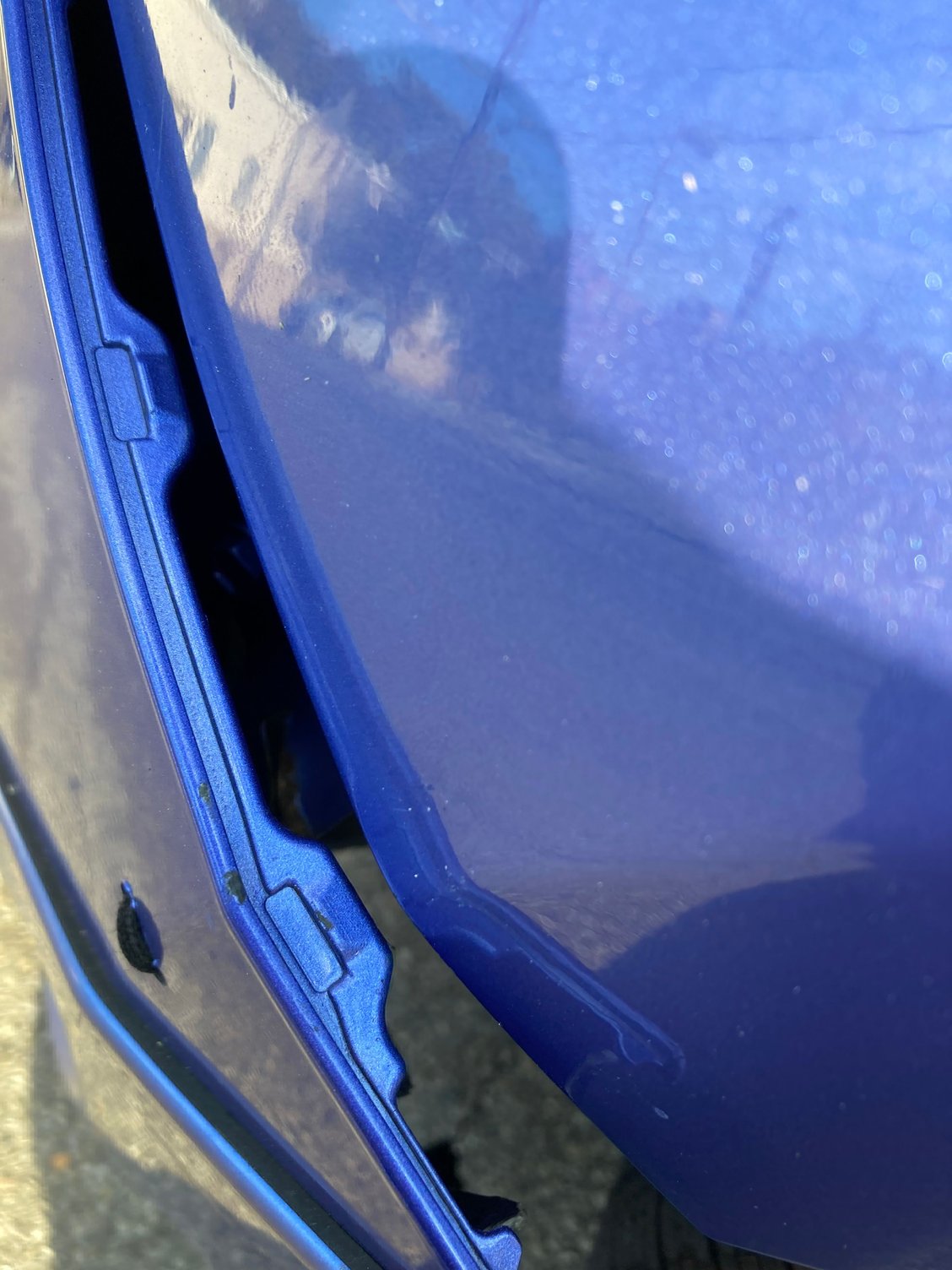

My Second Gen xB seems to be missing some clips or a bracket on the sides of the bumpers connecting to the fender. It’s both the front and rear bumper. It seems like this may
be a common problem. I see that a lot of the clips are available online but I’m trying to find the right ones. If anyone could point me in the right direction I would really appreciate it.
Thanks!

The first two shot actually show the clip assembly. The mounts have obviously broken, or don't have the bolts in them anymore. It's the large grayish bracket tat needs to be replaced and bolted solidly back to the car.
The front ones are called bumper stays and are items 52535 and 52536 on this parts diagram, https://parts.villagetoyota.com/a/Sc...4460-5201.html
The rear are called support rails and are here, https://parts.villagetoyota.com/a/Sc...4460-5202.html
