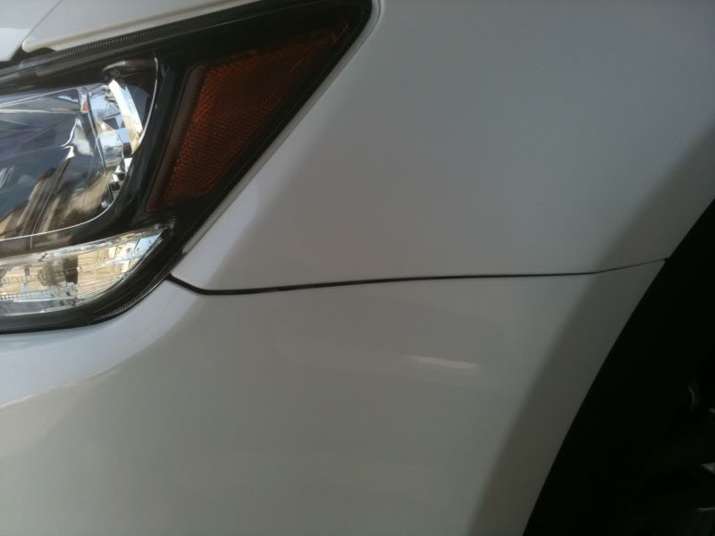

Hey guys, So my car was scraped by another car like a month ago, and i just got my car back from the dealer last week. i notice that with the new OEM bumper, there's a pretty big gap/sag between the fender and the bumper on my drivers side. I brought it back to the dealer today and I showed them and they took a look and said " the bumper is held onto by brackets, and not screws so there isn't much we can do to close up the gap." It is so noticeable compared to my passenger side and I just can't stop looking at it now because I do see the bracket inside. I'll take a pic and post it up tomorrow, but since the clips cant close up the gap, what can i do to close it up?
All the brackets between the fender and the bumpers are clipped on, one of them sounds like it doesn't really make that "clip" noise when i reinstall the bumper, but it does seem to look like its clipped though.
Any suggestions and help would be appreciated. THANKS!

I assume you're talking about the front drivers side fender and the front bumper. That's actually a very common problem for this car. Not to mention it's a common problem for a lot of cars and trucks. As you said, the bumper is held on by renention clips and not by a bracket. And as also said above ^^ If you go in there and find a place to zip tie the sagging area, that will more than likely fix it. If there's not an area, you can drill a small hole behind where the bumper meets the fender and put a zip tie through there. They're just plastic so drilling is no problem

lol ok i dont know if were on the same page but i probably just dont understand. This is what I'm talking about:

you can tell theres a big difference between driver and passenger side and when you guys say use zip ties, where am i suppose to zip tie the two pieces together to close the gap? i tried looking through under the hood but i cant even see the bumper from inside the bay.
any help? Thanks! and thanks the previous replies!

wear/tear from removing the bumper...those clips r all plastic and dont do so well when you take off and reinstall the bumper a few times it gets worse the tc1 had the same problem. what ever u do dont glue anything! tip ties r ok but glue is a mess and if u ever have to take the bumper off your going to risk messing up the paint or breaking something.

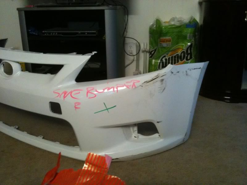

as for the pic of the actual bumper that got hit, this is what it looks like. there wasnt really any dents. it was just scraped pretty hard.
therefore i dont know if it damaged inside or not. i dont even know the problem myself.. i did look at the old bumper tho and it didnt look like the bumper was damaged at all, just scratches.
