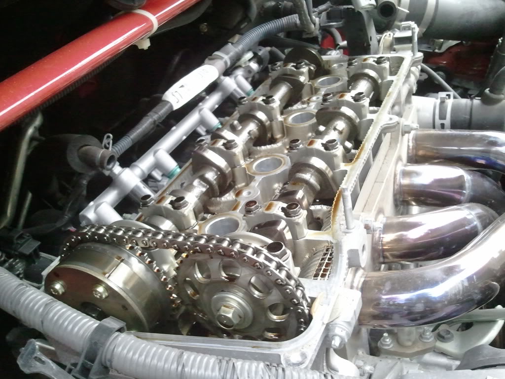

So i got a 2007 tc valve cover (i think) from a member here and slapped it on my box. Upon further inspection i did notice that the tc is different than the xb one. As you can see in the pics below. It bolts on just fine so that all i care about.
***EDIT*** so i know now the tc valve cove does not work with the xb coils. the xb coils are longer and thus a spacer is needed before you bolt the coils down. after putting on the cover 2 of my coils failed. so the dealer replaced and i put spacers down. a few washers so the coil was not bent or anything.

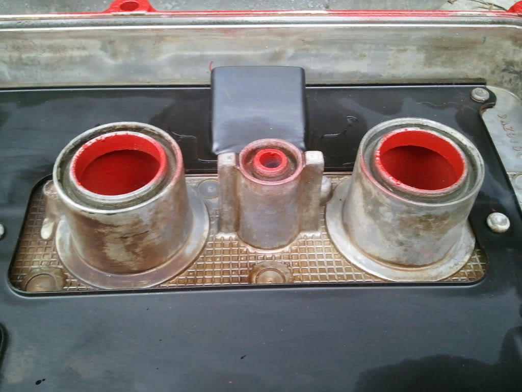

the top one is the 2009 xb with gasket still on it and the bottom one is the 2007 tc
the 2007 tc cover seems to have a hach pattern molded in. also only 2 molded ribs where as the 2009 xb has no hatching and 4 ribs

2009 xb below

the 2009 xb also has some kinda of extra tab next to bolt holes

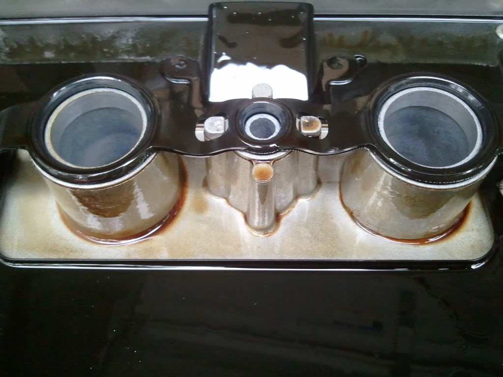

2007 tc with no tab

here is the valve cover with the 2009 xb gasket in it

here is the motor with no valve cover
new valve cover with out coils

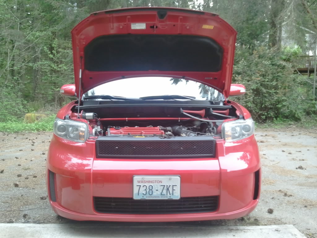

and everything back in its place

It sounds like a case of cause and effect but we can't rule out coincidence. Anyway the new VC looks great.
