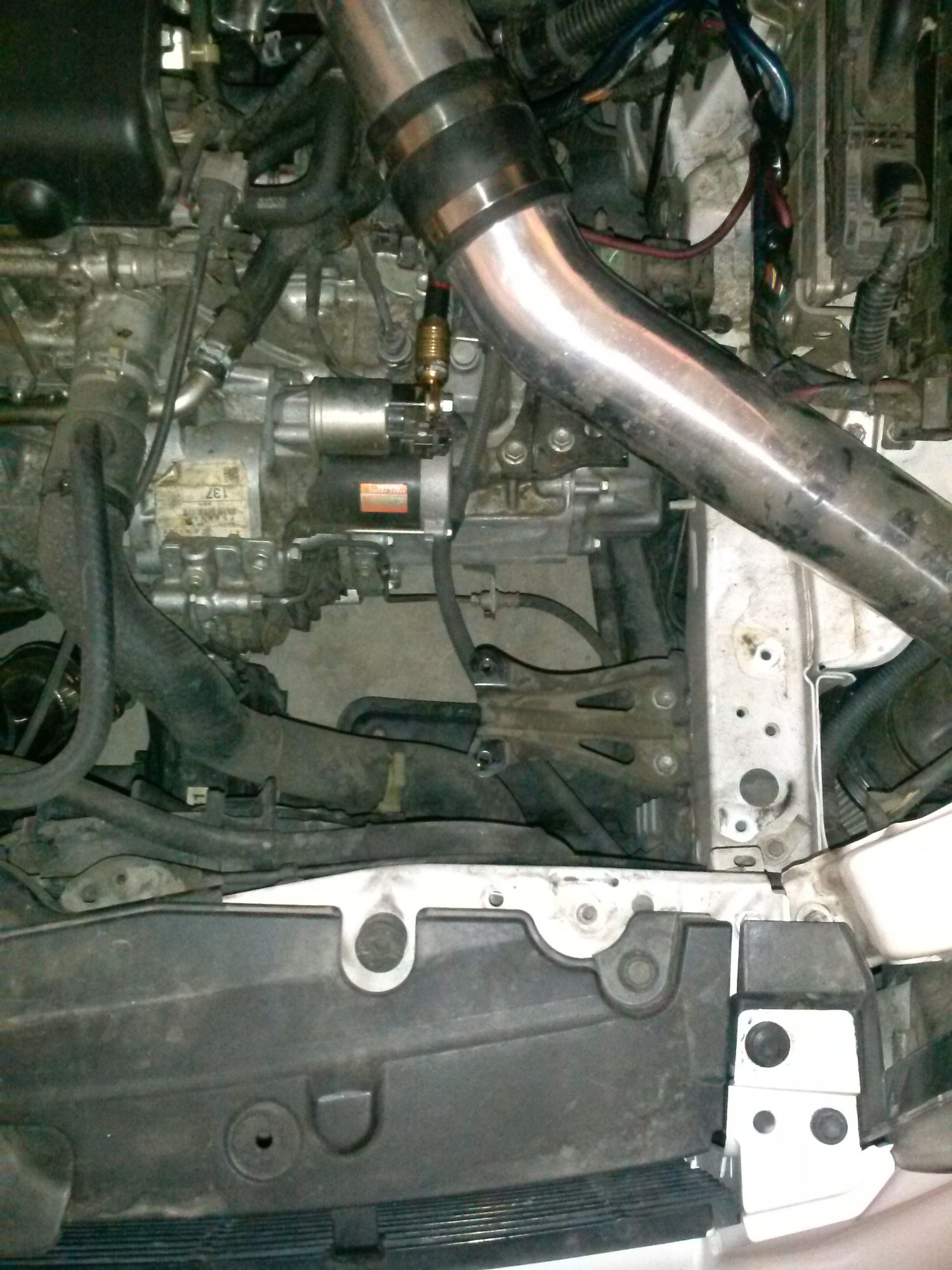

Here are a couple photos of what I'm dealing with.
A friend and I just did a motor swap on this 2010 xB. I purchased a compatible 08-15 used motor from JDM engine depot.
The previous owner destroyed the original motor. We have just about everything ready. I forgot to take photos of the coolant and air hose routing.
Does anyone have photos or videos of this?

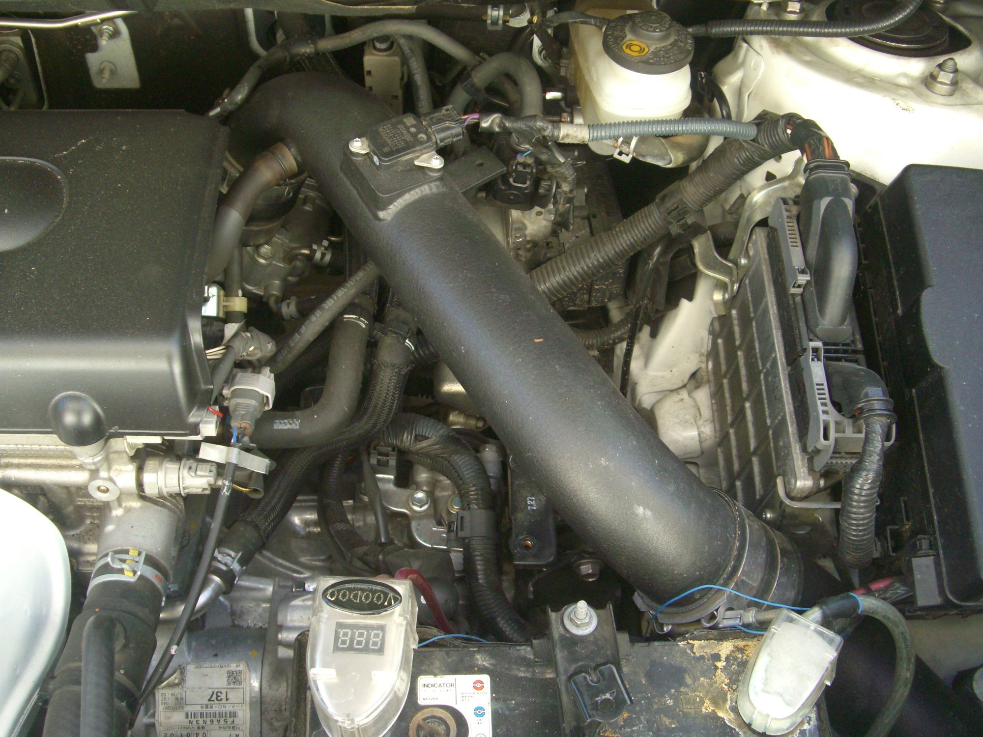

Here's some shots of mine when it was closer to stock. Hopefully these help.

Nice find...that should help the OP quite a bit I would guess.
