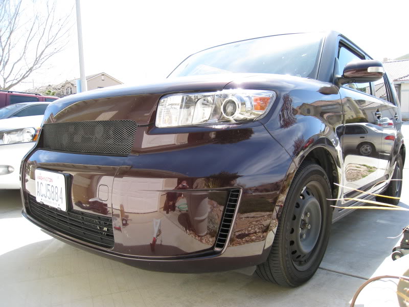

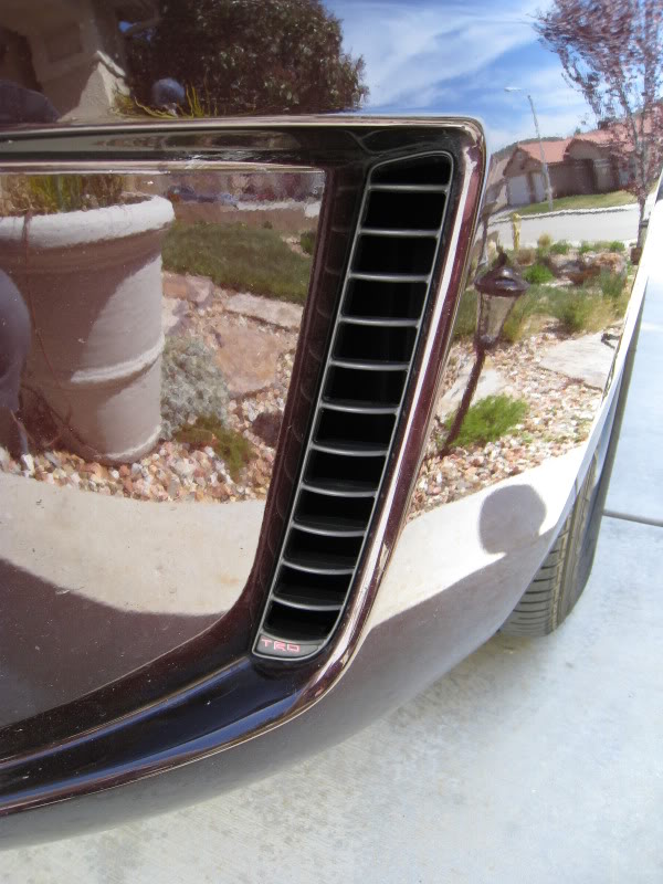

Cleanup took about 15 minutes, a little carb cleaner I had sitting around, a rag, water hose, file and dremel. I even took a few minutes to polish up a rough spot and grind down the MAF mount there was slight warping from the welding.
Installation from start to finish took me a little over 30 minutes, that includes cleanup.
Please excuse my filthy engine compartment, my car hasnt gotten its first spring bath yet.

Sounds good, didnt have a chance to open it up because of traffic but past 3k rpm it rips. I may eventually paint it but overall I am pleased, especially with the cost.
