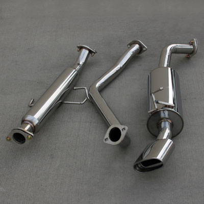

I have the Tsudo Dual cat back Exhaust and love it. But the one thing no company has done is a scuba tank replacement. The only exhaust to come complete is the Ebay system's.... I would love to have and see a direct replacement for the scuba , more power and some more sound would be great.
