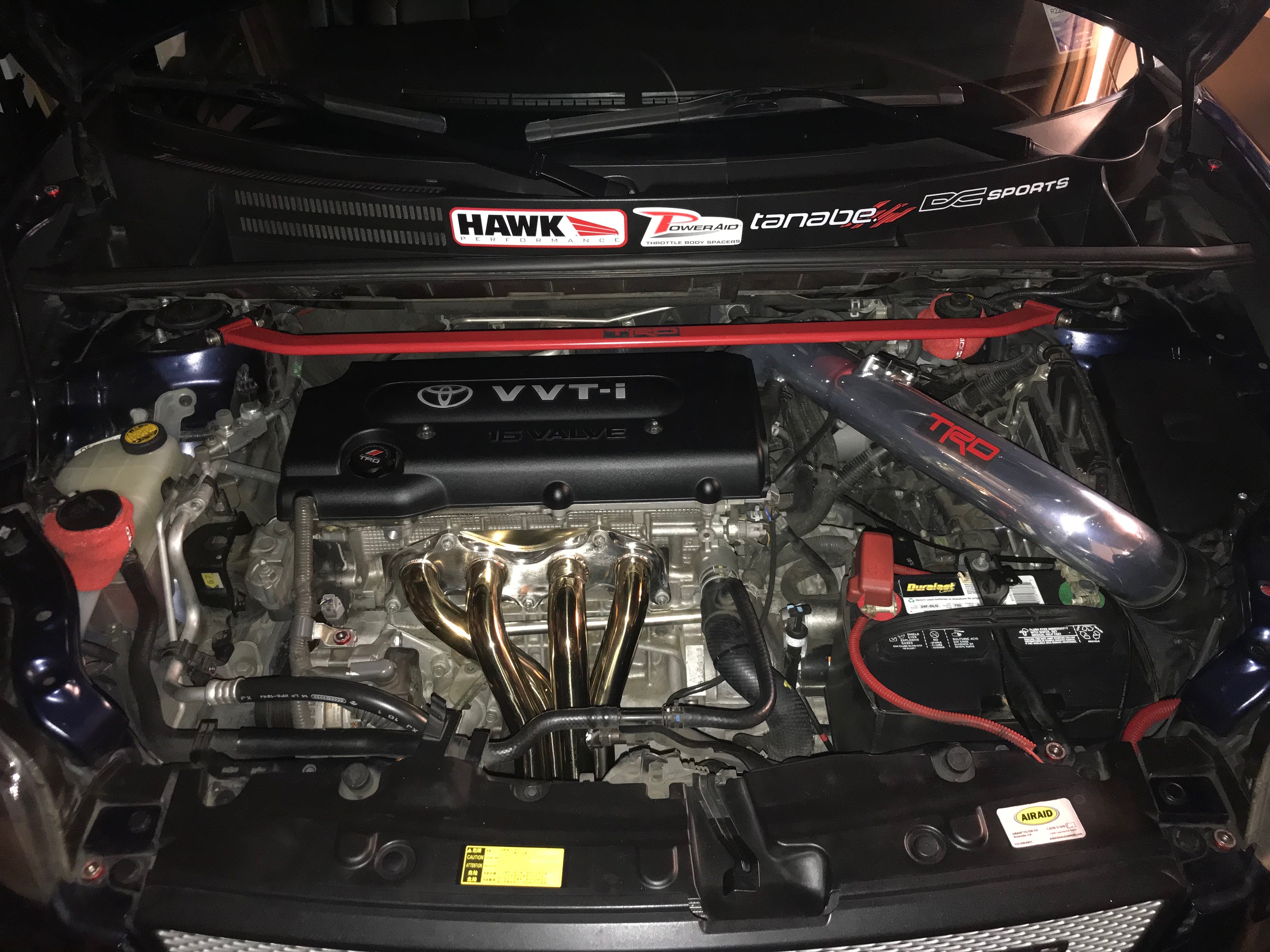

Attempt 3: DC Header + weapon-r cel eliminator
Months later I decided to give it another try with the DC Header. These are all machine built and you can tell when bolting this thing up. It fit literally perfect. no leaks. welds are beautiful and they are gorgeous as well. So in the end I wish I would've just went with DC in the first place. I used the stainless 4-2-1. The sound is just slightly deeper with a slight bit of rasp at 3/4 throttle which sort of disappears at full throttle...or my intake is louder and i just cant hear it anymore. either way sounds nice. Ive heard of some people fitting a high flow cat welded in since this removes the stock one and that sort of smoothes out the rasp. I didn't do this though.
Weapon R CEL eliminator: fits and worked perfectly. No codes on any of the three headers. I have the DC on the longest now for about 2 weeks and all is good. Ill report back if anything changes.

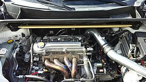

Sucks that you had to go through so many iterations to get something that worked correctly. As an add on to the ones you have run the Weapon-R header fits great with no leak issues and as an added bonus you don't need to bend the dipstick to fit it.
Excuse the dirty engine shot.
