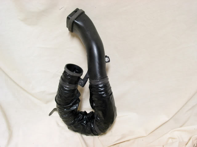

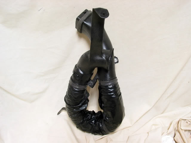

The snorkel is easiest to remove with the battery out. There's a bolt ahead of the fuse box into the fender, two snaps anchoring the intake flare and the loop, and finally disconnecting and extracting the loop. It's completely reversible and definitely no cutting or such required. The parts just couple together.

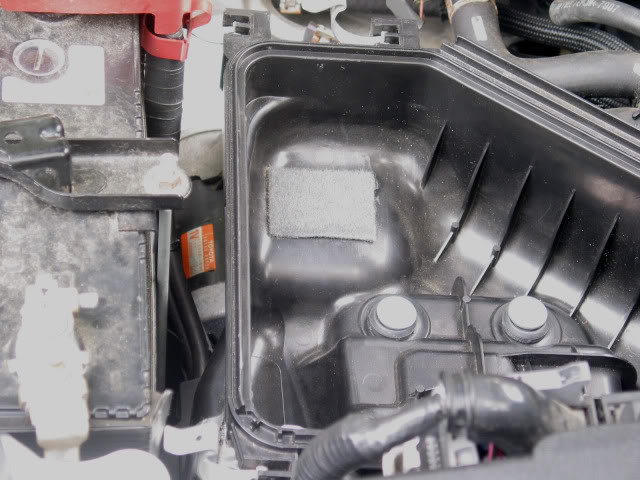

It so happens, I was particular about this. I very deliberately installed a CAI utilizing the OE air-box. However, to do so safely, I needed a way to allow air bypass in case of intake block due to water presence. My solution was to make an opening in the bottom of the OE airbox and install a flap over it so that normal air intake would be from the left front fender, not the engine compartment. Here is a photo of my solution.
You'll notice directly beneath my installed flap two bolts that anchor the air-box base to the transaxle (the third bolt not being visible in this photo, but no less present). The OE air-box base provides no openings were I show a flap -- I specifically created a hidden opening for the purpose of hydrolock protection. Speaking for myself, I never identified any openings within the OE airbox that would protect in any way against hydrolock. However, given the high location of the OE snorkel air inlet in the forward engine compartment, there was no need on Toyota's part to provide such protection. It's only if one chooses to modify the OE air inlet that such considerations become appropriate.

My airbox came with these 2 drain holes in the bottom. I can't recall ever seeing a oem airbox that didn't have drain holes.
