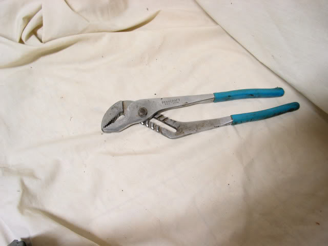

3. I then removed the two clips that secure the cable ends to the shift levers (long nose pliers) and pulled the cable ends free of the lever studs. Then remove the two U-clips that anchor the cable jackets to the support brackets. I found large offset adjustable pliers helpful in extracting the clips -- wiggle them side-to-side a little while pulling up.
(offset adjustable pliers)

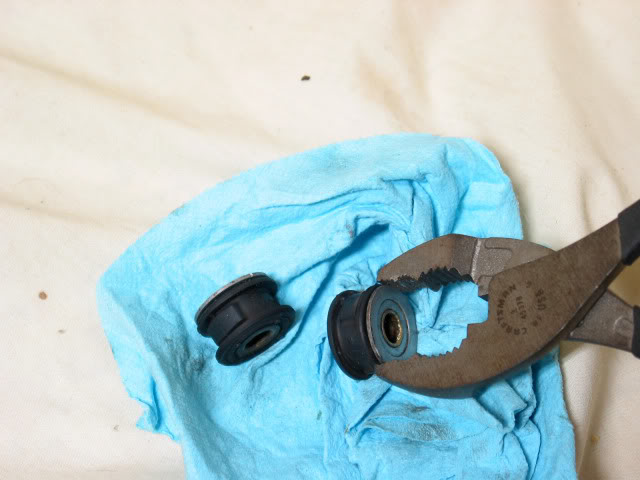

6. The next step is removal of the OE bushing from the cable end, which I found to be pretty easy by grabbing the washer side with a pair of pliers and twisting and pulling at the same time.
(use pliers to remove the OE bushing)
