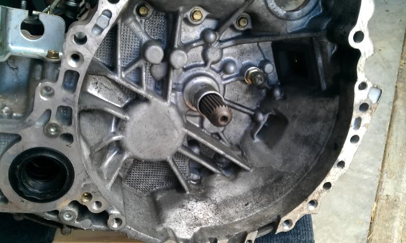

soooo...inside the bell housing...im seeing "E350"...not "e351"......is it facepalm time, or can I phenaygle it in there?

The Camry appears to have used the 30300 5spt MT to 2001, then the E351 from 2002 through 2009, the EB62 6spd MT was also used in 2009 depending on model and fully replaced the E351 in 2010. I see no mention of an E350. My best guess is that might be a sub-designation that points toward the specific setup.
PS. It's been awhile since I had a good look at the top of the transaxle, but your photo appears to match pretty closely to what I remember when fussing with the shift bushings.

Indication being the E350 is actually a tC1 transmission. I then verified the E350 was indeed the tC manual transmission prior to the tC2. I expect the difference is purely gearing, but it means your transaxle isn't from a Camry . Hope that isn't a major problem.
