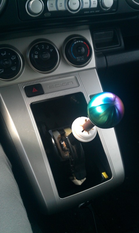

hehehe, sooo...there might be an e351 hanging off my engine right now.....
Waiting on a rear motor mount to complete the swap. Looking forward to having a 5 speed and a quaife lsd!

Thanks! currently waiting on the last part...a brace for the passenger side axle from a 5 speed camry. After calling the yota dealerships all over ky..there isnt one in the US. Waiting for one to be shipped to the shop so I can actually go drive the thing!

Of course I will be doing a write up!!!! I'm going over everything with the mechanic who helped me get it done right now, so I don't miss any steps! It was surprisingly straightforward, we just ended up waiting for random parts that we didn't realize we would need. It could be done in a weekend by an experienced mechanic if he/she had all the necessary parts.
