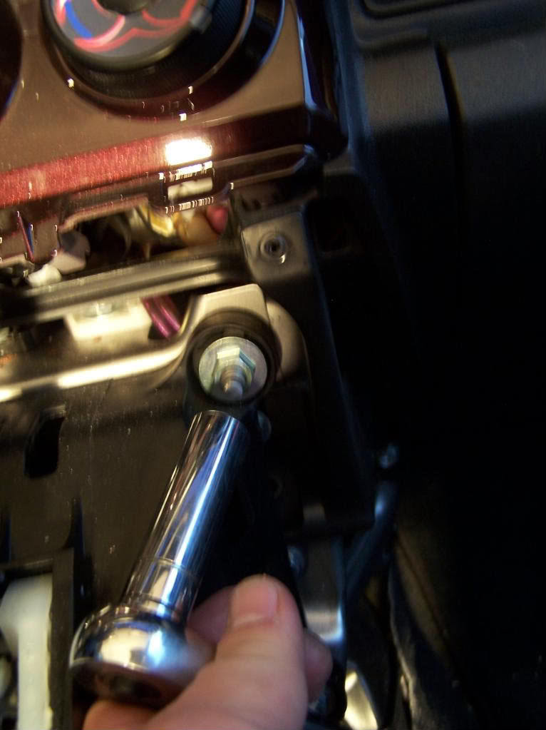

STEP 1: Remove shift ****
  • Remove the shift ****. just grab a hold and unscrew it.

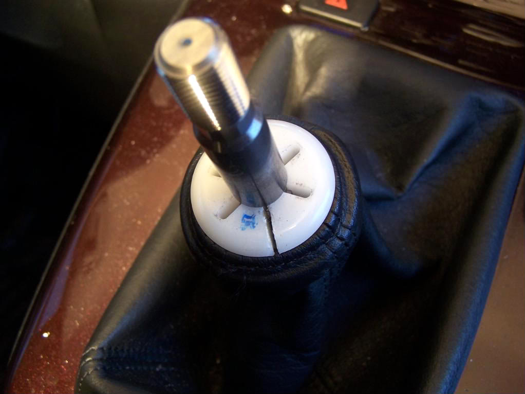

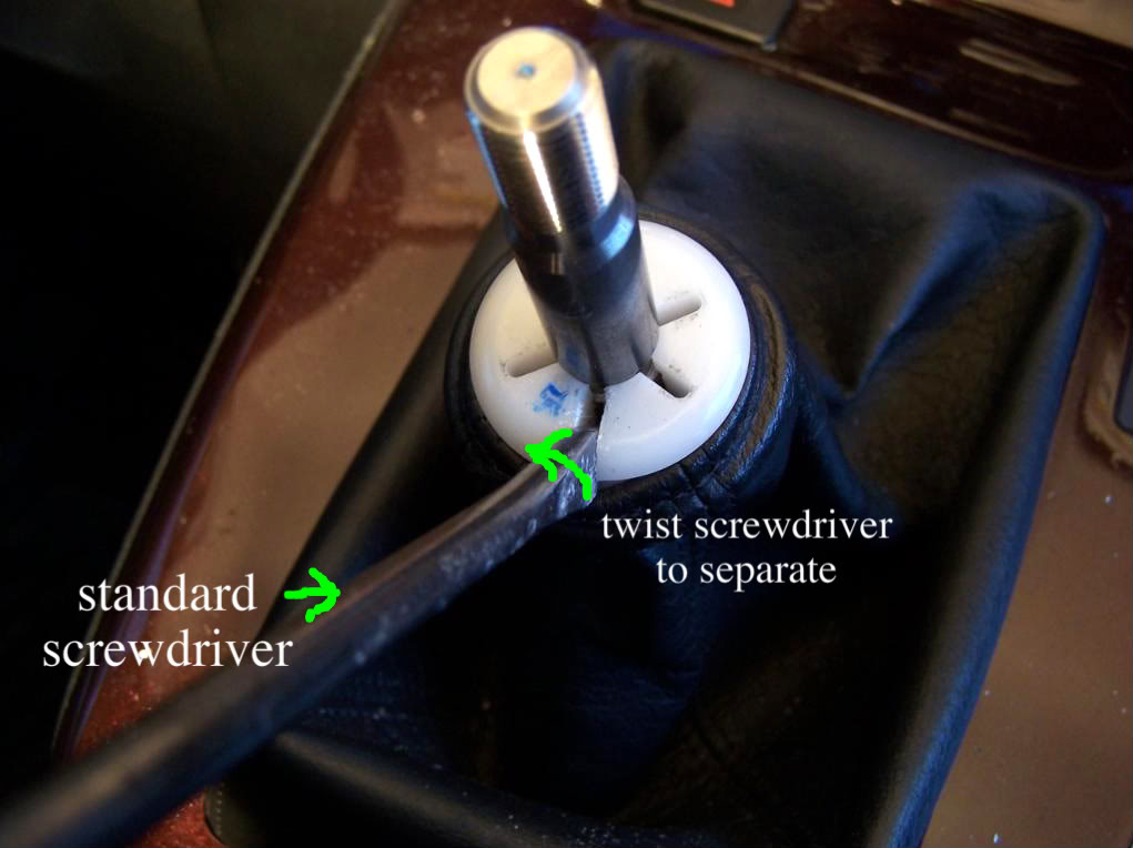

STEP 2: Release shift boot retainer ring
  • Locate the white ring holding the shift boot to the shaft.
  • Insert the broad tip standard screwdriver into the slit of the ring and gently twist. this will separate the ring from the shaft.

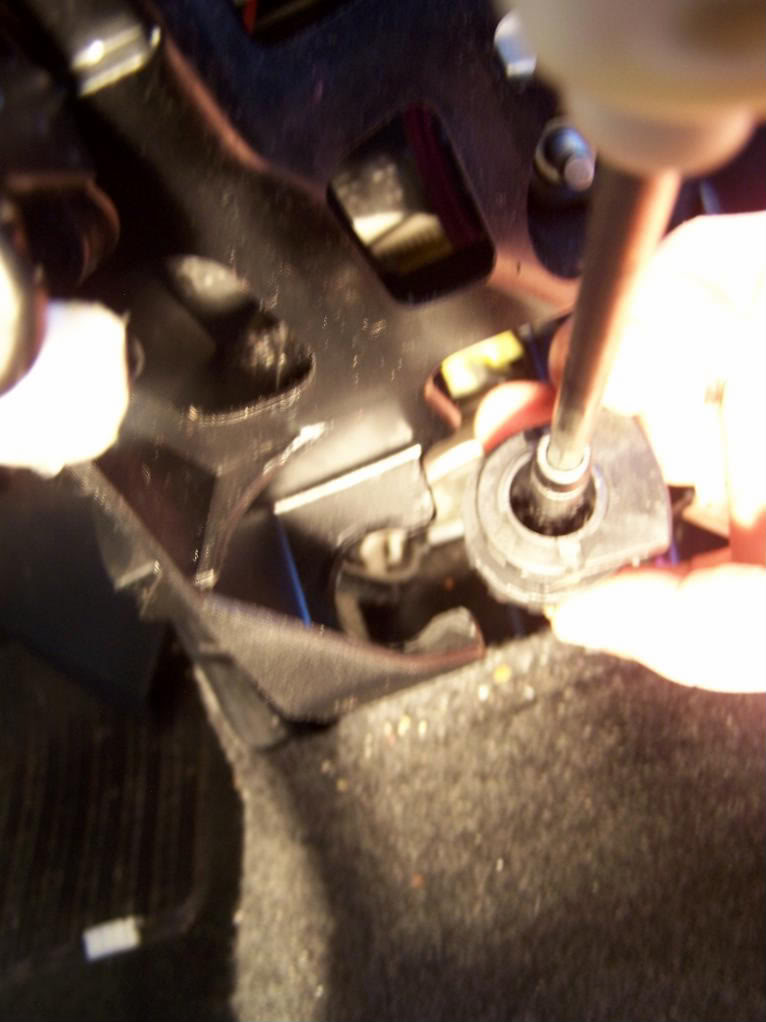

  • Gently lift the ring up shifter shaft but not completely off. this will help make sure that you don’t accidentally put a hole in the boot.

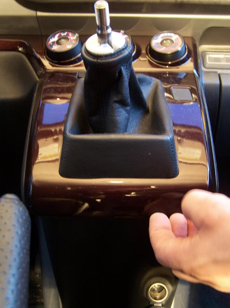

TEP 3: Remove the shifter bezel.
*NOTE* DO NOT use tools for this step.
  • Using your fingertips, grip the bottom of the shift bezel and firmly but gently and slowly pull upward. there are a total of 4 clips holding the bezel in place.

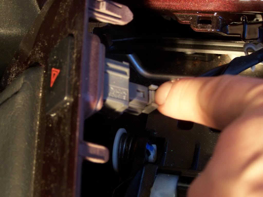

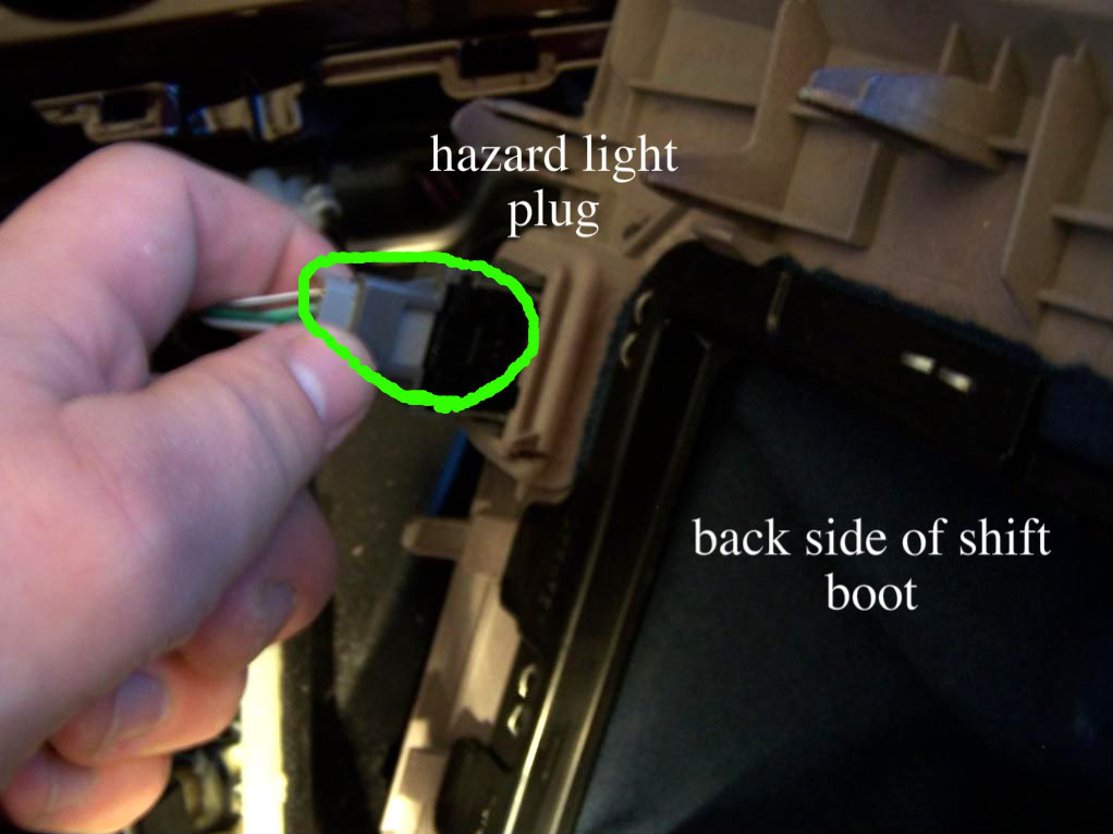

  • Disconnect the hazard light plug (squeeze latch)

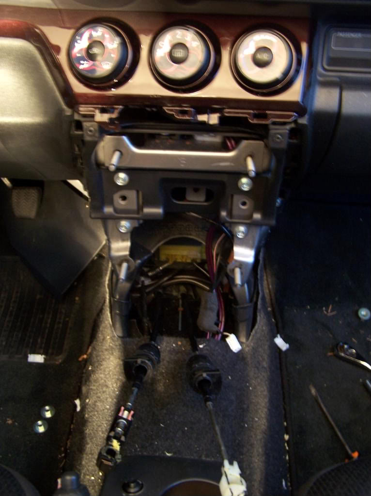

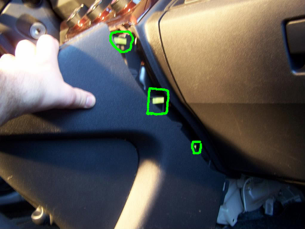

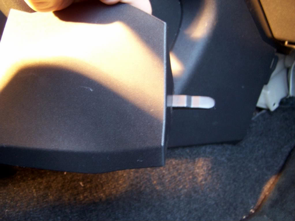

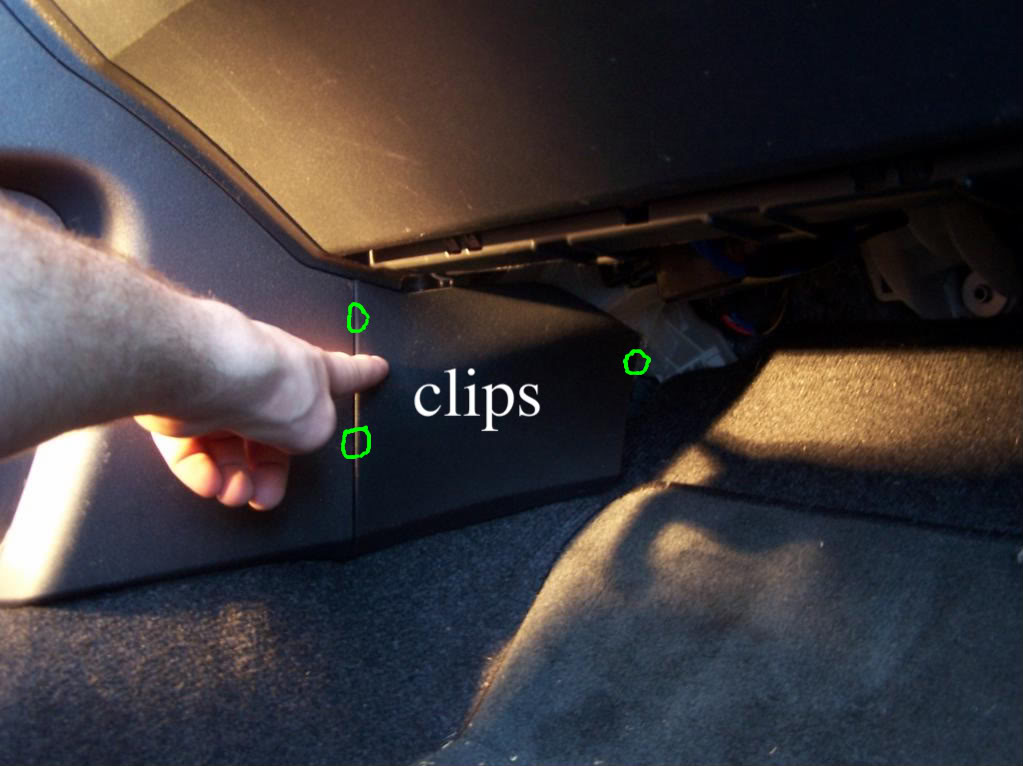

STEP 4: Remove shifter console.
  • Locate the side panels in both driver and passenger side foot wells. They have guides that slide into openings. remove these panels (1 on each side).

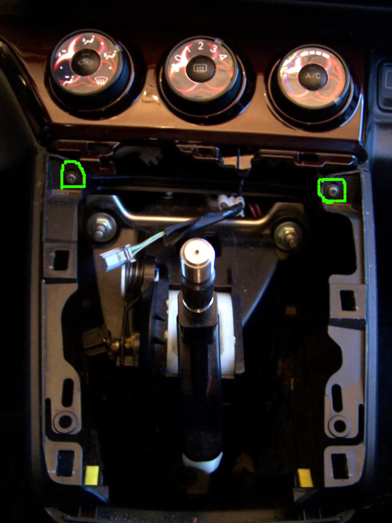

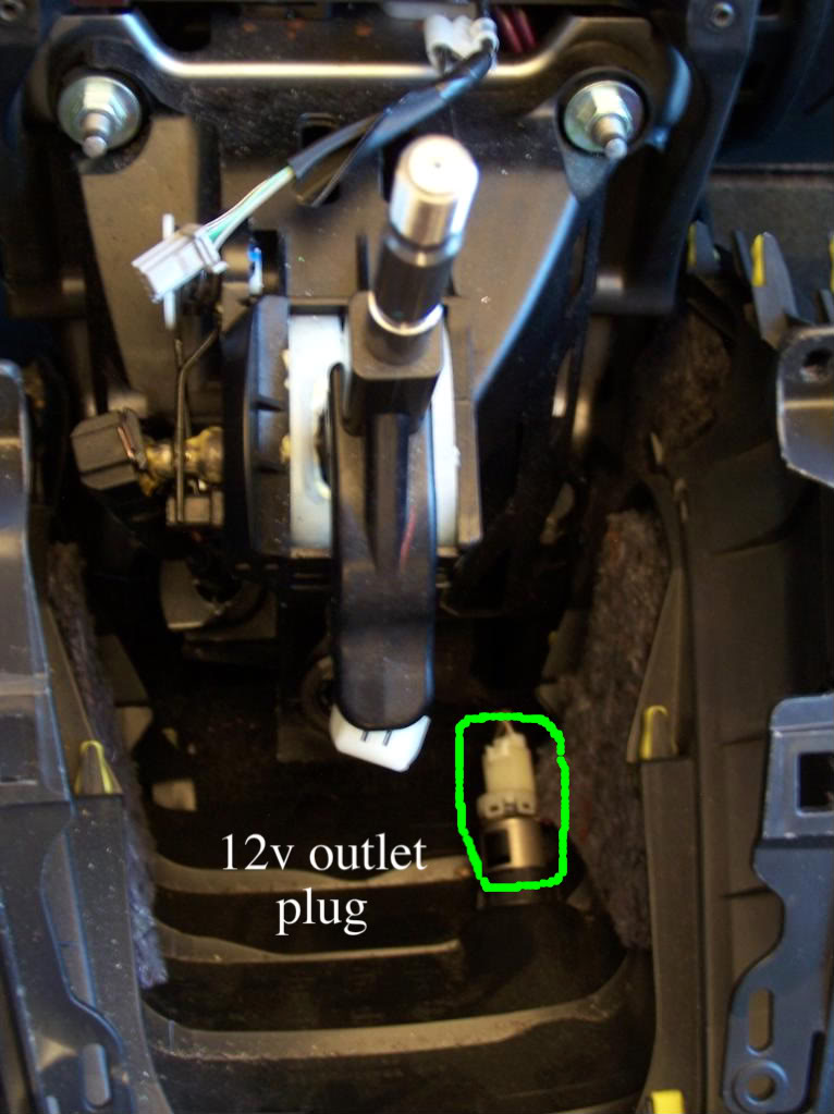

  • Locate and remove the 2 screws at top left and right.
  • Unplug the 12v power outlet at the bottom right (squeeze latch again).
  • Firmly pull the console back towards you. there are 3 clips on each side holding the console in place.
  • After all wires have been disconnected from the console it is free to remove.

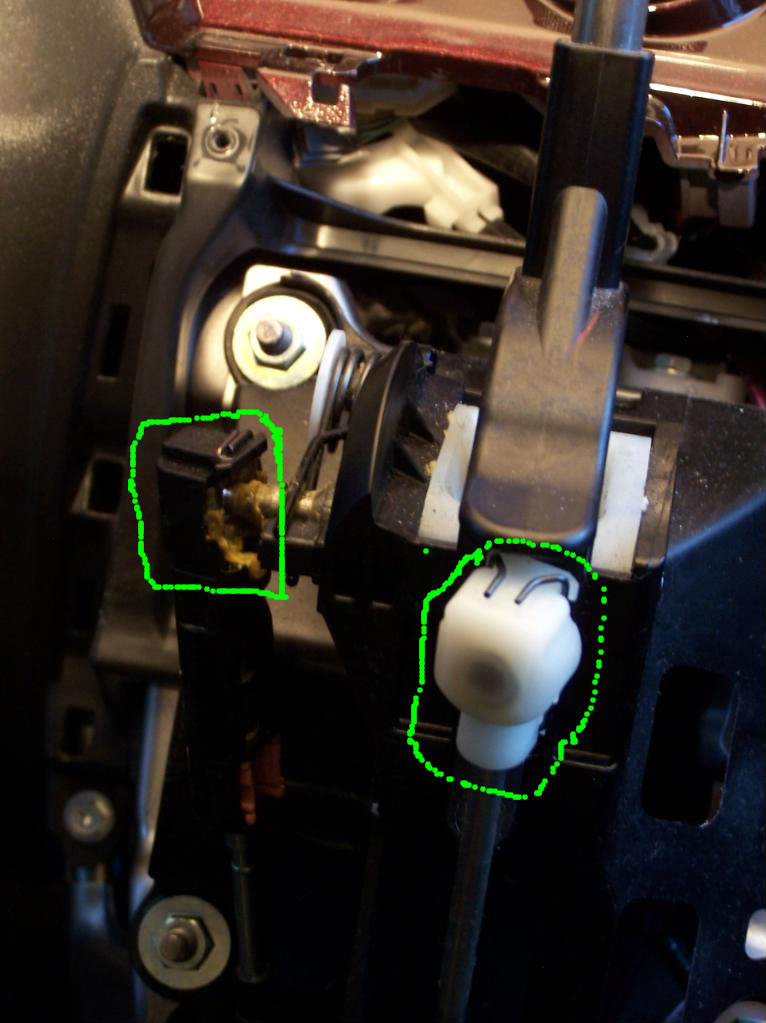

TEP 5: Locate and remove shift cables from top of housing.
  • There are 2 cables that connect to the shifter housing. One on the driver’s side and one right in back.

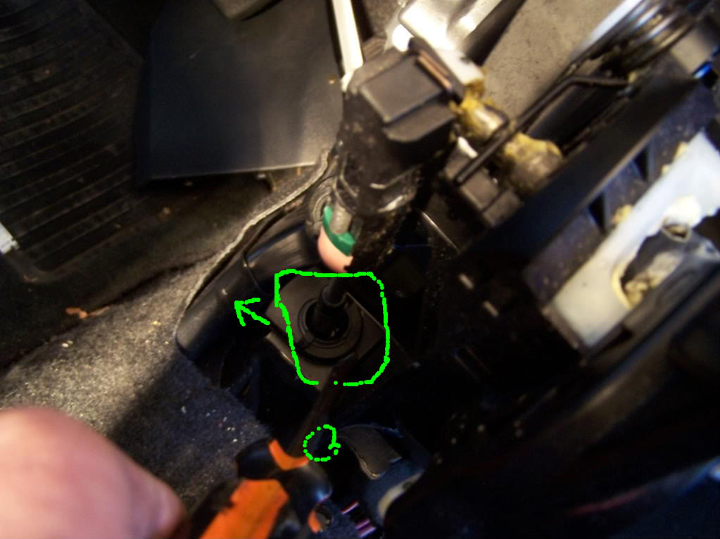

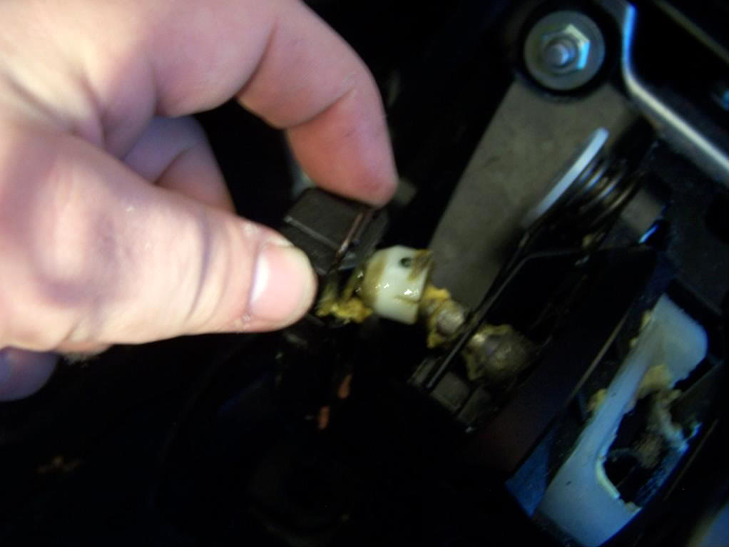

  • 1st the one on the driver’s side: This is where the rags come in handy.
  • You should notice 2 little wire like ends holding this clip in place.
  • Using a standard screwdriver insert between the clip and slowly twist. the metal clip should separate and the end moving towards the middle.
  • Pull the cable away from the shifter housing.
2nd cable:
  • You should notice that this cable connector is different than the 1st one.
  • for this clip use a standard screwdriver or your fingers and separate the ends of the clip outwards.
  • pull the cable away from the housing.

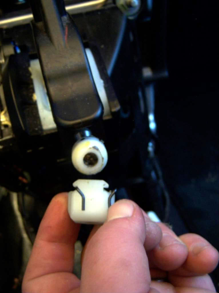

STEP 6: removing shift cables from bottom of housing.
  • follow the cables down to the bottom of the shifter housing.
  • you should notice a white colored plastic retainer clip.
  • using your fingers pull this retainer clip out. You might have to use some force. DO NOT use a screwdriver. this could damage or break the clip. *If you are having trouble with the clip using a pair of small pliers might work.
  • repeat this step on the other cable.
  • Pull the cable away from the bottom of the housing. If you cannot do this by hand the use of a standard screwdriver will come in handy. Use the screw driver to pry the cable from the housing. *SEE PICTURE*

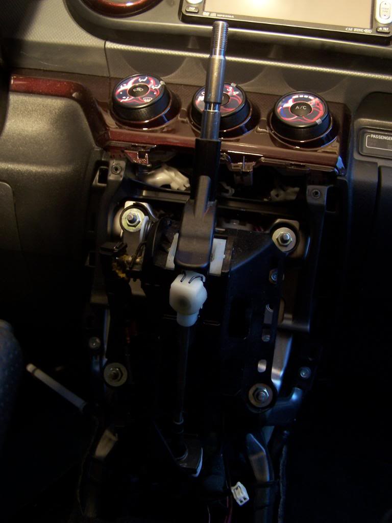

STEP 7: Unbolt housing from vehicle.
  • Locate the 4 12mm bolts holding the shifter housing to the vehicle.
  • using the 12mm deep socket and ratchet loosen all 4 bolts before removing them.
  • Remove all 4 bolts.
  • Pull shift housing away from vehicle.
  • It should look like this now

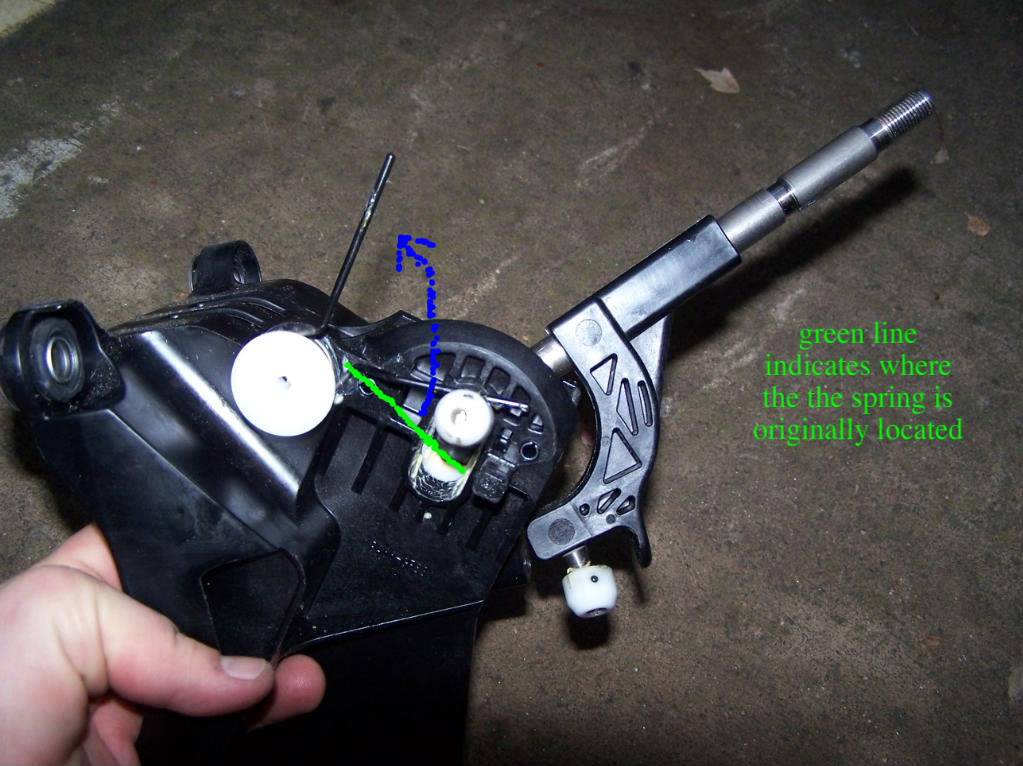

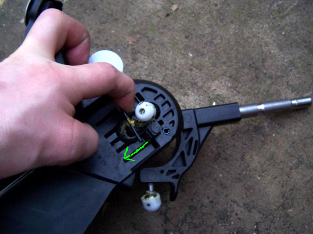

STEP 8:

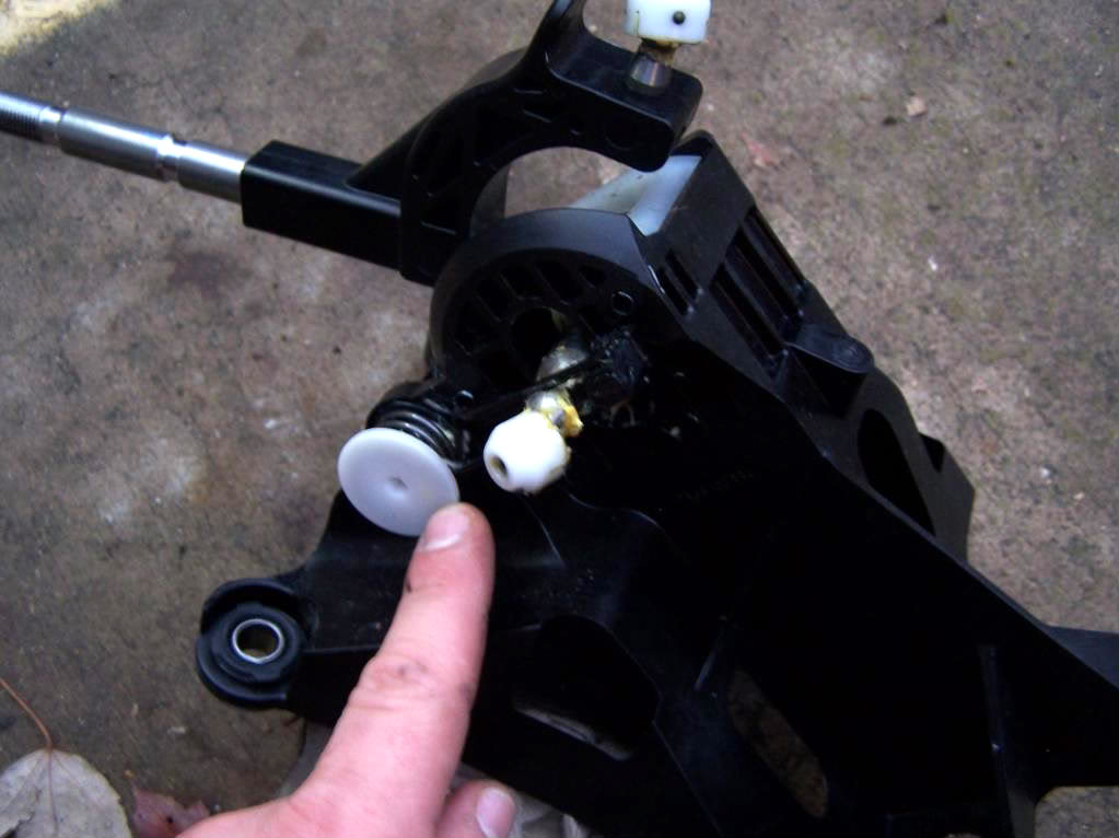

Remove return spring.
  • With the shift housing out of the car you can either use the return spring from your original housing or not.
  • I chose to install it cause I like the extra side to side resistance on the shifter.
  • The new short shifter does not require it and Trevor recommends not to use it.
  • Using your finger pull the bottom arm of the spring down and then over the bump stop. *see picture*

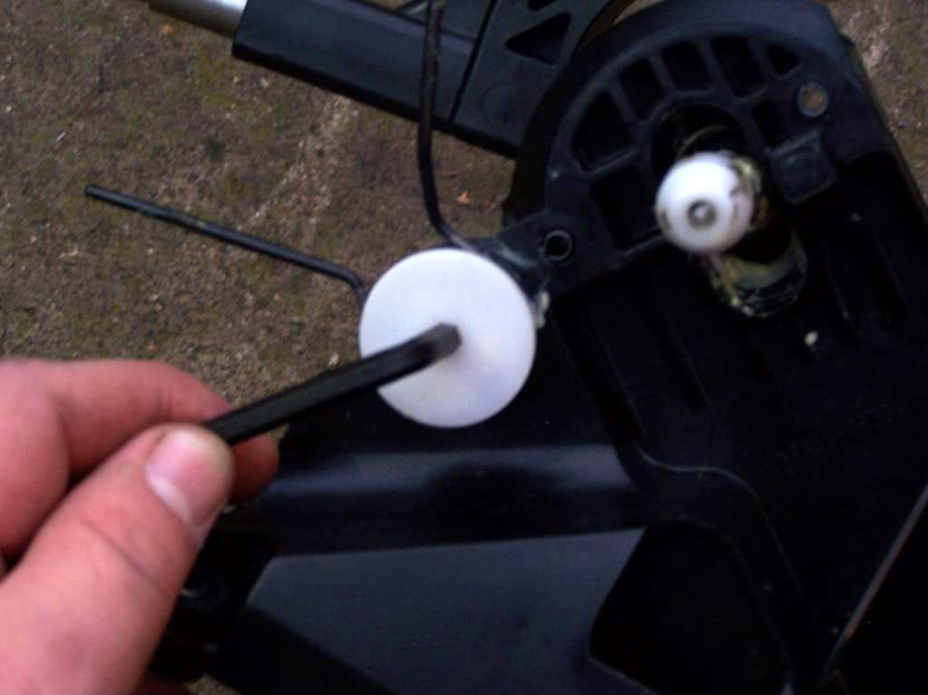

  • Next use the allen wrench and turn the white round retainer clip counter clockwise 90 degrees to remove the spring
  • install the spring and clip onto the new shifter.

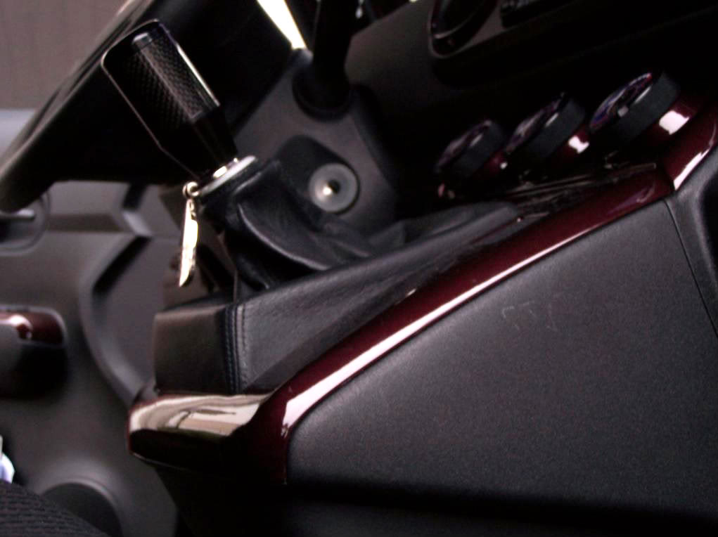

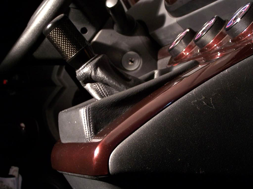

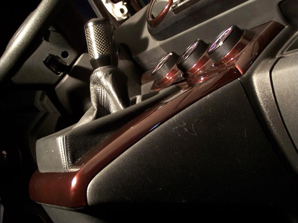

FINISHED PRODUCT:
Before and After:

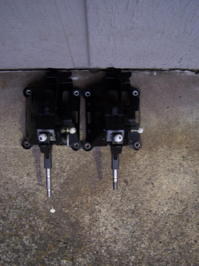

here's a shot of the stock and the modified side by side:
