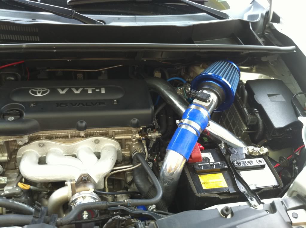

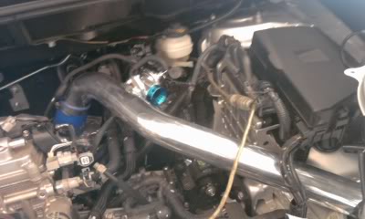

Default Ancla In ATL UPDATED! with pics

Old Sep 10, 2010 | 07:21 AM
ScionFred's Avatar
Posts: 3,387
From: Baltimore, MD, USA
Looks good! It apears that I'm not the only turbo-charged AT XB any longer. You should have had them add a ATF cooler during the install but you can always add one later on. Just don't beat the snot out of the tranny without one.

i do have the check engine light, vsc light and traction light. i need help getting rid of some of these lights. the codes i throw is p0101 and p0192. other than that the car runs great.
The P0101 is "MAF out of range" and is very common. I couldn't get rid of it until I made a new intake to correct the MAF sensor readings. Your P0101 probably has to do with the funky design Ancla uses for the MAS. You can fix it with a new MAS tube for about $100. 3" AL straight tube, K&N MAS flange and labor to weld the flange on.

Bank 1 rich, that's common. Unless your injectors are bigger than 440cc or the MAS tube keeps causing this, the P0172 should stop coming back after the ECU has enough time to adapt to the new fuel trims. That's how it went for me anyway.
You should try this 3" MAS tube without any insert:
http://www.summitracing.com/parts/SPE-9405/?rtype=10
This would be a very cheap way to see if that funky Ancla MAS tube is the CEL culprit (I think it is). I haven't had a CEL in over 2 weeks now since I put a CEL pipe on my 2nd O2 to get rid of the P0420. Like I said before, I had a recurring P0101 that wouldn't go away with my old intake/MAS tube but it hasn't set even once with the new 3" intake/MAS tube. The MAS needs to be positioned as close to oem as possible, not sticking out of the pipe 1".
therefore what you are saying is that i can get rid of both my lights.
I can't promise anything but IMO there is a very good chance that this $32 MAF tube will get rid of both your codes. I'm running 440cc and a straight 3" MAF tube and CEL-free. It should work for you too.
Also check your clamps on that intake coupler. It looks crooked in the pics and you do not want a leak there.
