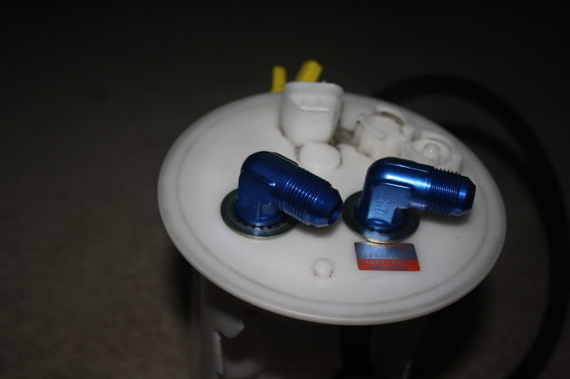

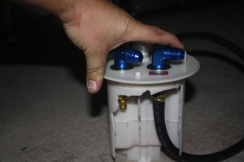

so this has now become my fuel pump journey
so the only way i saw sensible is this you might only need one but i need 2 so our stock fuel pump sux here is how far i have got after a hour with a dremel and some dykes and alot of beer. dont mind the wire nuts i was to lazy to walk to my workk truck and get crimps so temp holder

Here is the link to the photo bucket for all the pics of it stock vs now and i will take pics of regulator install and other things
http://s65.photobucket.com/albums/h2...6/fuel%20pump/
