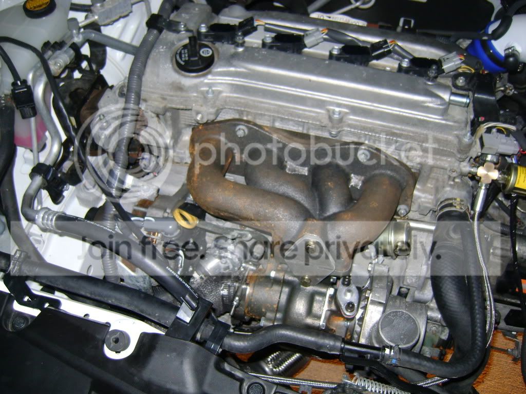

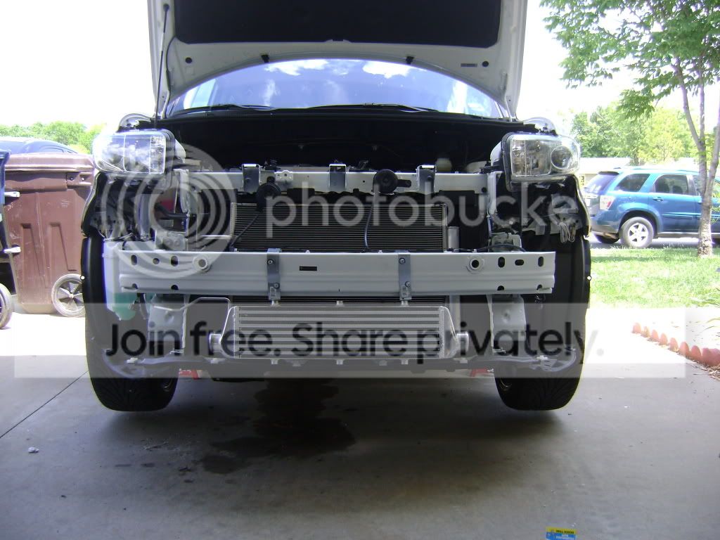

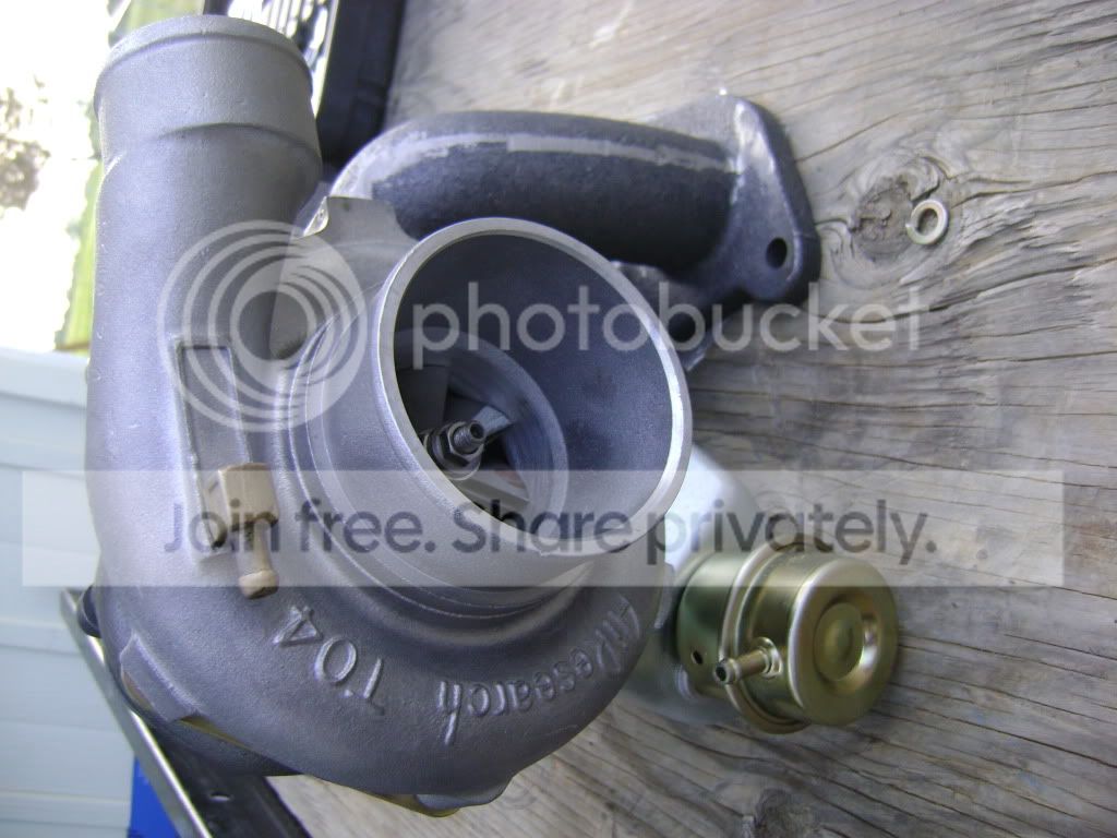

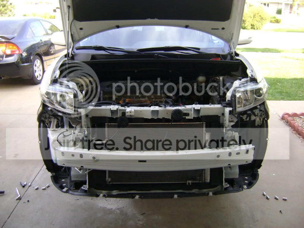

The project began yesterday, we have already ran into some problems not big but slowed us down. The turbo is a Greddy T3/T4, it came with an internal wastegate so I was planning on just useing that for now, but the wastegate was hitting the motor and the mani could not go on all the way. Well good thing my friend is a welder and we custom fab the bracket to the wastegate so we could make that work.... Then we finally get back from his shop around 11:00 last night..... well im sure yall seen homer and his downpipe pics, but having a internal wastegate it comes with a v-band type downpipe. I have only so much room to work with. The coolant line is sitting right there pretty much against the v-band and the car had to go to the exhaust shop today. When I get to the shop the guy looks at the turbo and says no way he can make that bend. So I thought well I guess Ill order my external wastegate now and just wait another week, but I need my car. The guy said to leave my car with him and he will see what he can do. He made it happen, I went back and saw what he did and it will work, but he kept the car over night to finish in the morning so today was kinda a waste cause he had the car all day and yesterday the bracket took forvever. Here are some pics tho but tomorrow alot will be going down and way more pics.

Yea those downpipes are a PAIN!

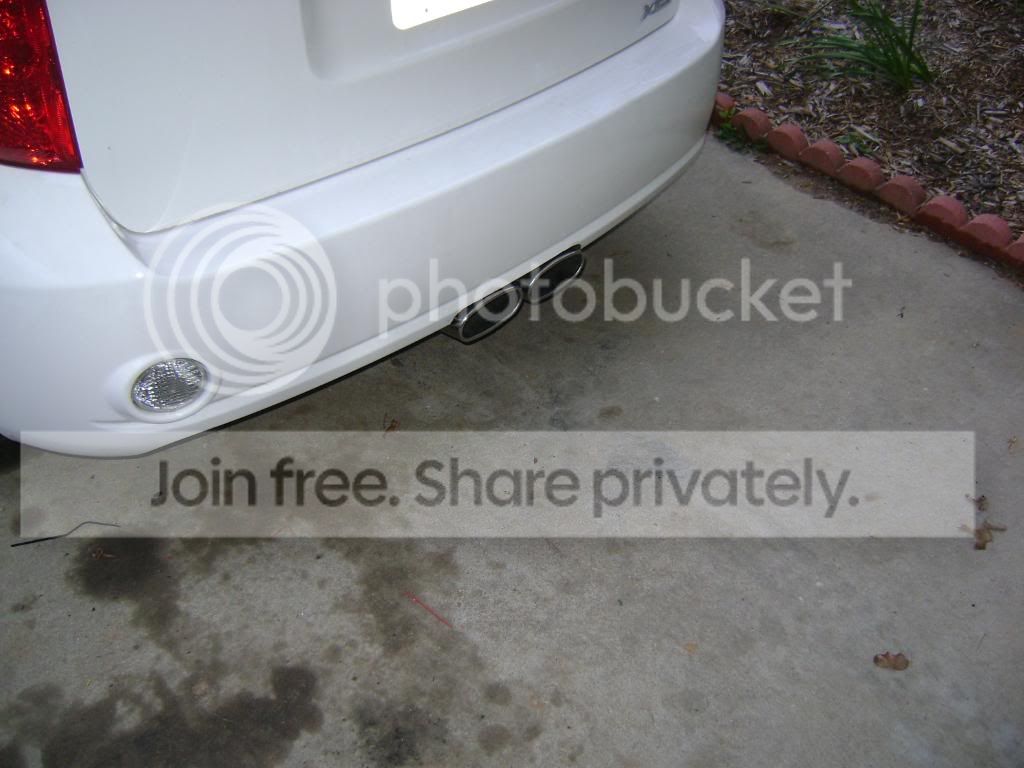

Just an update....Its 1:25 in the morning and I just got finished working on the car. Im too tired to post pics right now but we got alot done today for the time we had. The FIC is hooked up, intercooler piping ran ,exhaust is almost done. Just need to add the muffler and the tips. Gauges should be done tomorrow. Location of gauges are different then anybodys I seen yet. Will post pics if I get a chance tomorrow.

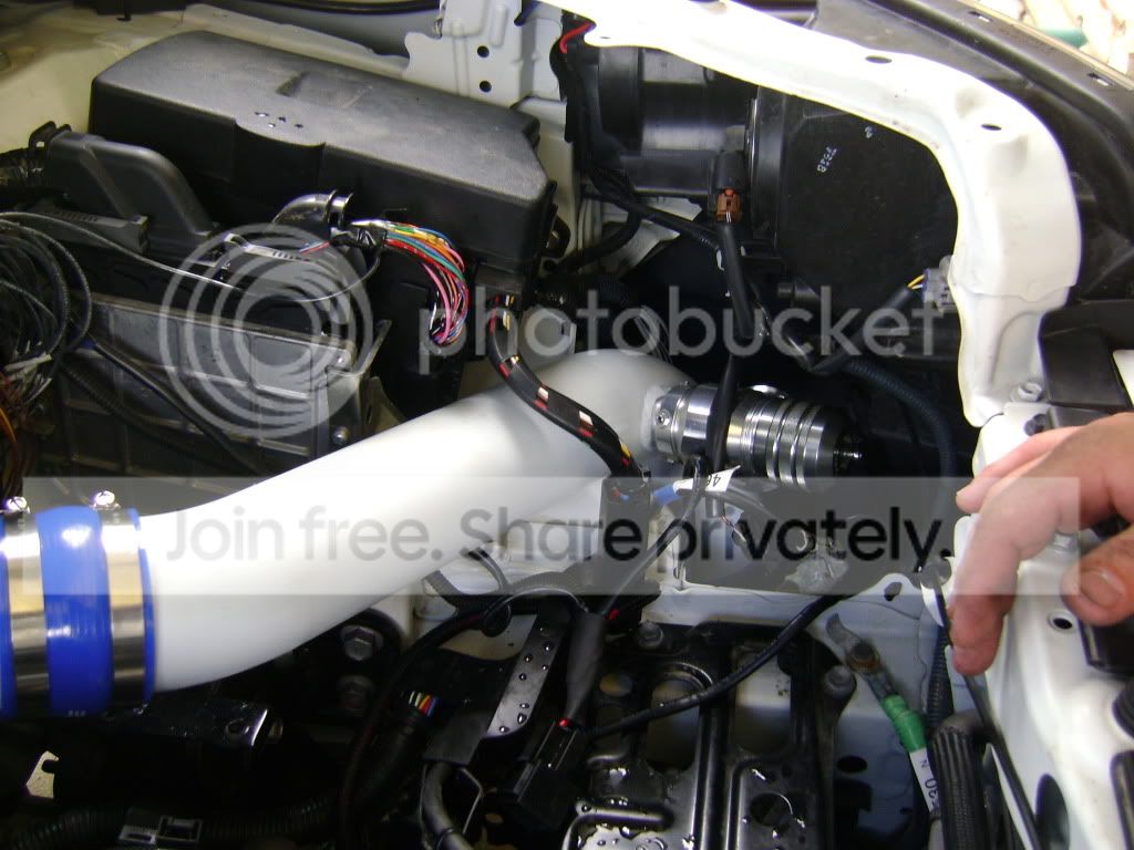

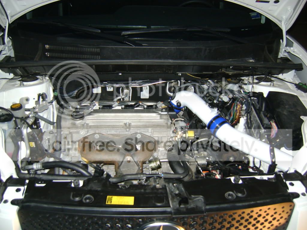

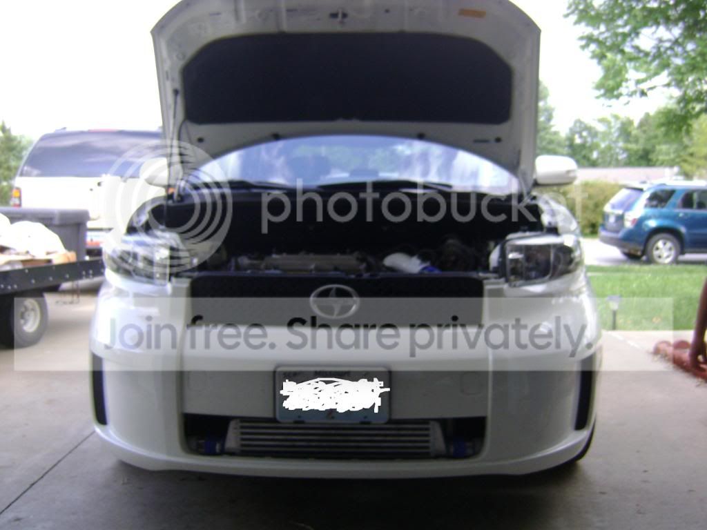

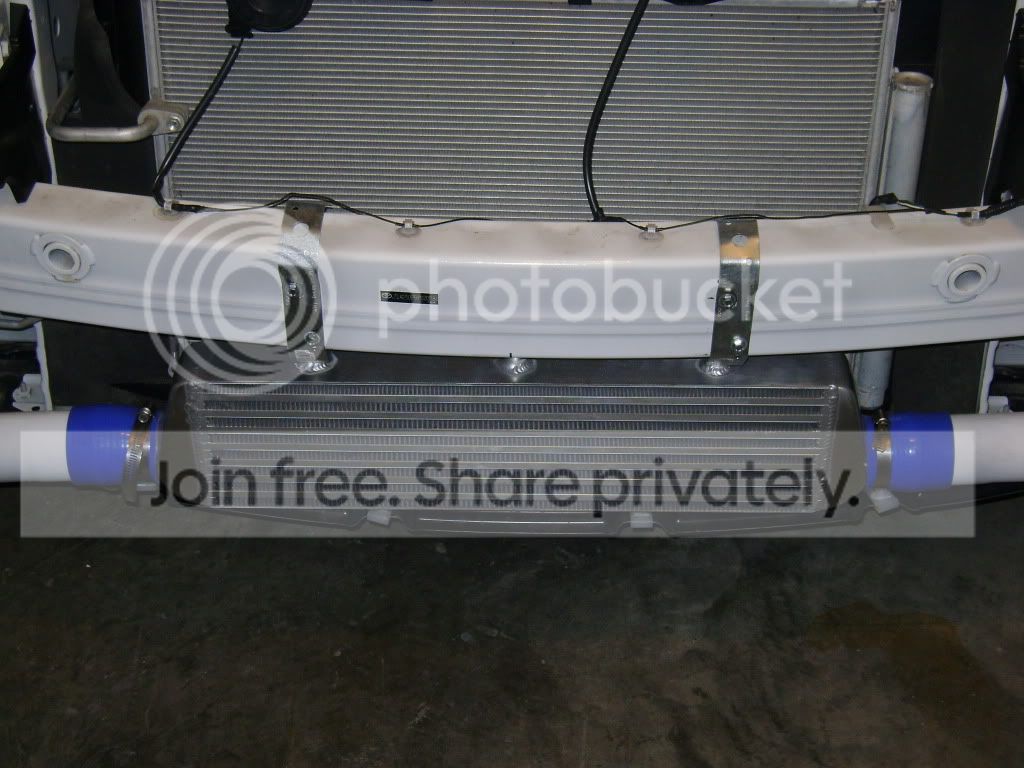

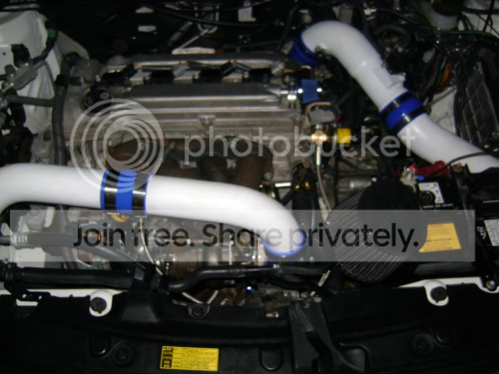

Here are some more pics, hopefully the car will be done today after I get off work. My friend needs to finish up the muffler and tips. Its a sick set up. Will post pics when finished, prob one of my most fav things that is done with the car. The gauges will finally go in today and load the FIC and that is it. Its rainy pretty bad but hopefully it ends by the afternoon. The other day it rained so the manifold has a few water spots on it, so it looks pretty bad in the pics.
BOV Turbo XS RFL
Old May 27, 2009 | 01:45 PM
Mach-box's Avatar
Joined: Jun 2008
Posts: 372
From: Buffalo
Looks great.
Old May 27, 2009 | 02:31 PM
Beckenbauer's Avatar
Music City Scions
Posts: 541
From: Murfreesboro, TN
white pipes ay...looks sweet dude. in for the finished product and ideas for my setup
Old May 28, 2009 | 04:45 AM
homerhitta's Avatar
Posts: 137
From: Levittown, NY
lookd real good! hope everything finishes up real well!
Old May 28, 2009 | 05:07 AM
ScionFred's Avatar
Posts: 3,387
From: Baltimore, MD, USA
Lookin' good! Good luck with everything. Mine goes on next week.

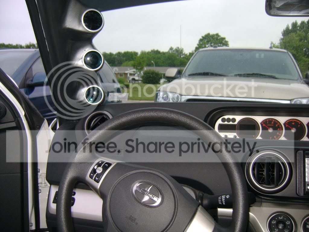

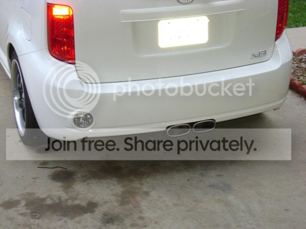

Well I have good news and bad news. The car is done but when I went to start it, you can hear it cranking but the car would not turn on. Anyone have this problem after there install? We were guessing that the fuel pump wasnt primed cause the car has just been sitting there for a week now, but then my buddy looked in the engine bay and saw the oil feed line was leaking, so he went to tightin it and it broke the treads right off the adapter. So I just ordered a new line, I was planning on getting one anyways but didnt think this fast so with the weekend here, prob wont recieve till early next week. Thanks for all the comments. Here are some more pics........

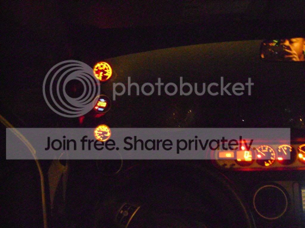

Prosport Gauges

YELOSUB's Avatar
Wagonistas
Posts: 4,080
From: AZ
Don't have any suggestions for you but i'm sure some of the turbo guru's on here will...Congrats on the install and i'm sure you will have it running in no time...Turbo looks great by the way,..Love the exhaust too...
