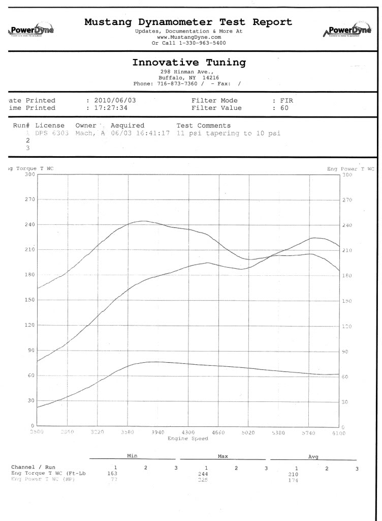

Okay so i finally got back to innovative tuning for my dyno. It was a good time. I just want to say my tune was conservative and nothing aggressive or anything like that. Also this was done on a Mustang Dynamometer, so typically the numbers are going to be less. I don't know the percentage. Also my print is super light so i am going to trace it so you guys can read it. Thanks.
This is the original scan. Hard to read.
I have a copy i traced too, if that one is to hard to read.
Numbers are 225whp and 245tq on 10psi.
You have some issues from 4500+ RPMS. Probably det or too much timing pulled. What AFR? How much timing pulled? Is that bottom curve boost or AFR? Also, what did Mike set you back for the pulls?

Bottom is the boost curve. I have to check the map to see the timing being pulled and see what the exact AFR's are. I was there on the Dyno for about an hour and 15. He played with the map and such. It was not cheap. The hourly rate was 178$
The turbo seemed to top off around 12 psi. It didn't seem to want to hold. So I decided to keep it at 10.
There's a .48 A/R on that turbine right?

I am not sure on that. It might be like a .43 or something along those lines. I got the new info when i got it back from Garrett.
