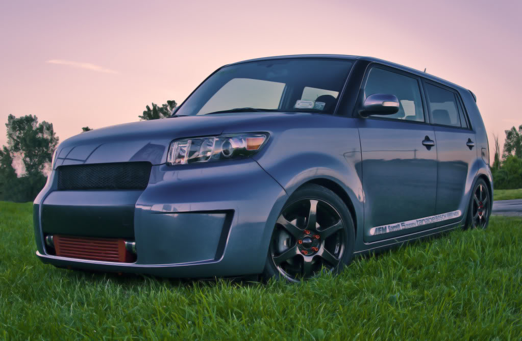

Old Jun 30, 2010 | 06:06 PM
  #87
Mach-box's Avatar
Joined: Jun 2008
Posts: 372
From: Buffalo
Just thought i would throw up a pic.
Lookin' good, Mang! Did you take/edit that photo? It's really cool, looks like a painting.
Old Jul 2, 2010 | 11:51 AM
  #91
Mach-box's Avatar
Joined: Jun 2008
Posts: 372
From: Buffalo
I had a buddy of mine take the picture for me. I don't know what he did to it. i like it though.
