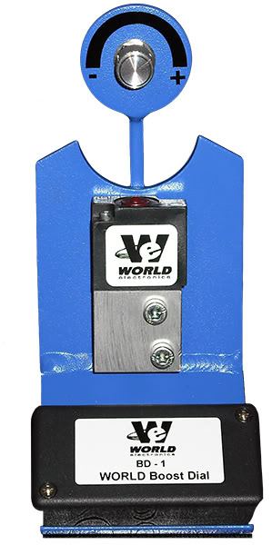

Old Dec 28, 2009 | 06:52 AM
Rob_DESCENDANT's Avatar
Joined: Feb 2009
Posts: 1,418
From: Torrance, CA / Reading, P
Check out our BD-1...it's a great bang for your buck! Works like a manual but is tunable like an electronic.
http://www.world-motorsports.com/wms...&products_id=8
$199.95 Shipped...
