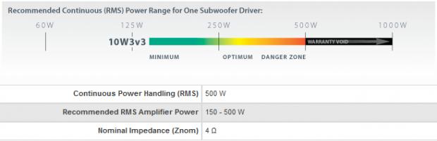

So the sub is 4 ohms and the max rms watts is 150-500. The 2 amps I am deciding on are either 400 watts rms at 4 ohm or 200 watts rms at 4 ohm. According to the chart on the JL Audio website it says that optimum is around 250 watts. What amp should I get?
Thanks

I would suggest going with the 400 watt amp as it will not have to push as hard to get the power level you need and you can just turn the gain down to match the power output to the sub. This also leaves you the option when you upgrade down the line that you already have the power there.

Getting an amp that's too big is not as bad as getting an amp that's too small. A properly gain adjusted amp will power the speaker to its best performance and usually not blow the speaker. An amp that is too small will distort and clip, overheating the voice coil and burning out the speaker. It will also sound weaker, not in volume, but in impact and definition.
As to 2 ohm vs. 4 ohm, it's not about sound, but voice coil resistance in operation, and which one you chose depends on how many speakers and the capability of the amp. If you're using a single channel amp and you want to use 2 speakers, you'll run 4 ohm speakers in parallel. If it's a multichannel amp, generally you'll use a 2 ohm speaker per channel. The reviews saying 2 ohm speakers sound better usually depend on the above, but without any real comparison on sound quality, just volume.
