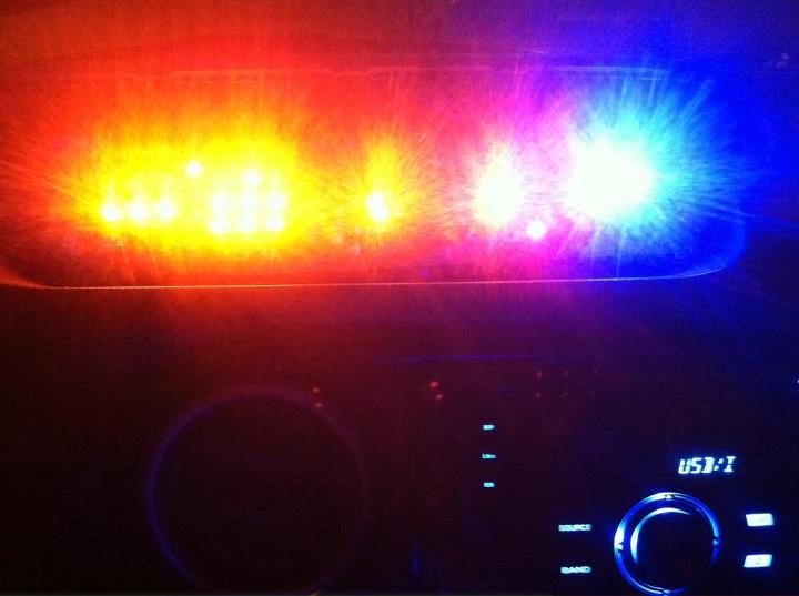

You can change the individual LEDs for everything from the LCDs to you parking break light. LEDmod.com has a good guide on this forum you can use (search for it). I am probably not going to use a new gauge face for now because ledmod.com's gauges are nice but a ____ing rip off.
as you can see during the day the orange gauge blocks out the blue LED light
but when it is dark the orange gauge with blue LEDs makes a nice cyan color that I actually like (the tach and fuel gauge are 2x brighter in person phone's auto brightness drowned it out)
pic of circuit board with just a few LEDs changed Name:  rH5pX.jpg
I'm actually not that lazy https://www.scionlife.com/forums/sho...d.php?t=212177 make sure you mark where you tach and fuel gauge needles sit to avoid spending a lot of time calibrating them like I did
der: like Cionide was pointing out, you actually have to remove the circuit board and use a soldering iron and remove the LEDs and replace them with whatever color you like
