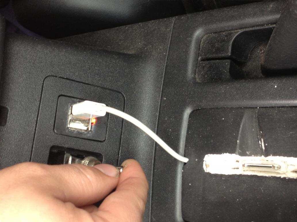

I hard wired a dual USB in my console I no it's not very clean but it will be when Iam done lol but it works great one is rated for an iPhone and othe cell phones while the other is rated for tablets like my iPad that takes a bit more juice.
