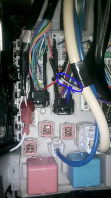

Anybody know the function of the circled wire or what its leading too? The wire is from my dd kenwood ddx712, but I have no clue what that wire is for. Bestbuy actually installed this unit in my car like two years ago.

Blue with a white stripe. Aint that the "power antenna" wire drom the HU?

I really don't know. Anyone else know? By the way this picture is from behind the knee panel, above the fuse box.

Its the Rear View camera reverse indicator...so when you put it in reverse it will activate the camera.

Oh ok, so I'm guessing the wire that its tap to is for the reverse light?
Yes Sir...
