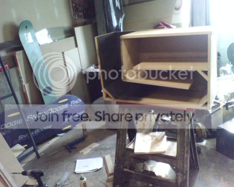

Anyway, build a new enclosure or have a new one built. Period. Prefab boxes are garbage and should be taken care of in the same manner.
Hit up www.hexibase.com. Pete knows his stuff and he'll make the most of what you have. You can purchase an enclosure built by him, or you can buy blueprints that he will tailor to your car and your specifications. Then you either have a cabinet shop build it, or you build it yourself.

It's a rear loading folded horn. The port tapers...

i see u like to put a few tricks in your boxes too... The angled corners.... nice.... we use silicone in the corners and fiberglass resin to stop the box from flexing. On spl boxes we use pvc pipes.. in undisclosed locations... even use an adjustable rear wall to tune port frequencies
