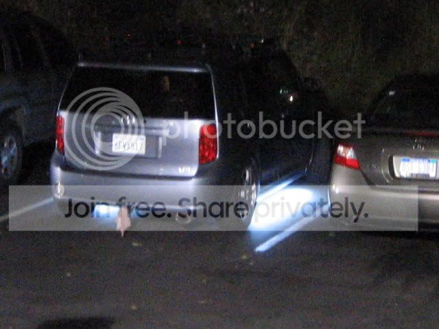

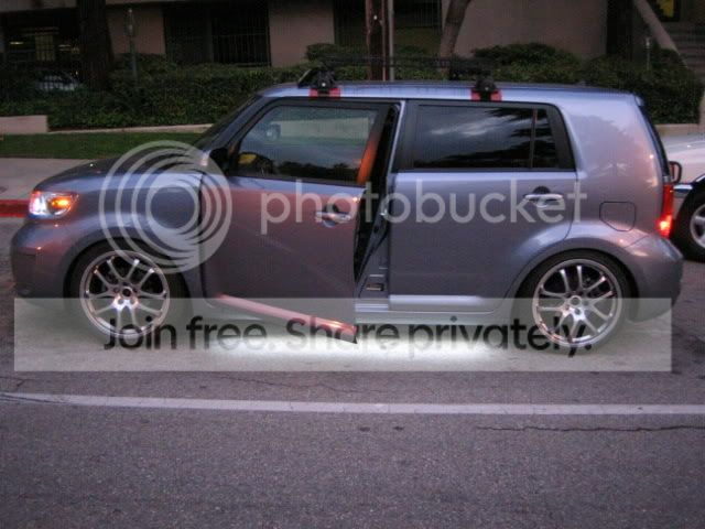

i just got done putting on puddle lights....used 40 LEDs on each side...lights up when i open the doors! fades in and out just like the interior lights.

Old Apr 12, 2009 | 06:10 AM
masterbB's Avatar
Joined: Oct 2008
Posts: 633
From: Santa Clarita
wow those are bright!

but still not bright enough to see during the day....barely noticeable during the day. I am satisfied with the way they came out......i didn't do the spots because people would say that i bit off BRABUS....so i just did a strip of LEDs...

for some reason the nightime pics look alot brighter than they actually are......

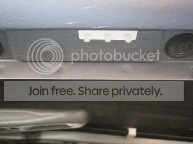

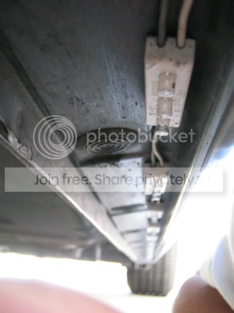

please post how you mounted them. Im in the process of desiging how to mount my setup. Just looking for other ways.

Old Apr 16, 2009 | 11:23 PM
ellisinseoul's Avatar
Joined: Feb 2009
Posts: 134
and then connected it to the lead to the door light switch...very simple..took me about 30 minutes for the wiring.
Old Apr 17, 2009 | 01:42 AM
redline8k's Avatar
Posts: 782
just doublestick tape...? easy enough I guess.
Joined: Feb 2009
Posts: 134
just clean the surface with acetone and windex and the 3m take will never come off!
Joined: Feb 2009
Posts: 134
if you take your lower dashboard panel apart...and look up towards the A pillar on the driver's side...you will see a thin 3 lined power lead to the dome lights....tap into the center line which is the line that fades in and out...the negative you can ground to the chassis.....as far as getting the power wire to the leds...i am sure that you saw the pics and will be able to figure out how to get the wire through the chassis.
