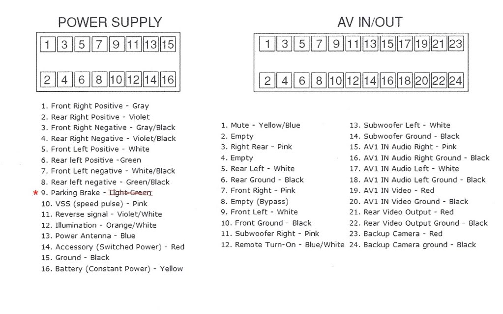

Originally Posted by RC-PILOT
The sticky above is great, but I start getting lost in all of it. I am ready to upgrade the Pioneer AVIC900??? with 2 amps new door speakers and a sub. The amps and sub are not an issue, but I need some specific answers...
1) Is there a specific "Pre-amp out" harness that I need for the back of the radio? If so, does anyone have the info on it? Or is the harness already set up for pre-amp out?
Here is the pin outs diagram for our radios...
Hope it helps you

The pre-amp outputs are already there and yes you will need speaker adapter plates as well.
