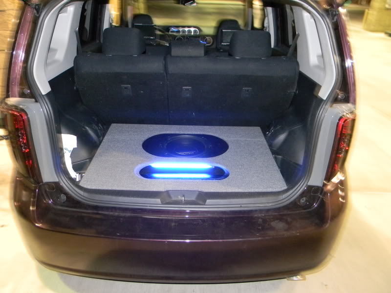

Got my xB in the shop right now, getting a jl 13.5 thin sub put in the spare tire area. Pics up soon!
Old May 29, 2011 | 08:07 PM
IronScion's Avatar
Joined: May 2011
Posts: 8

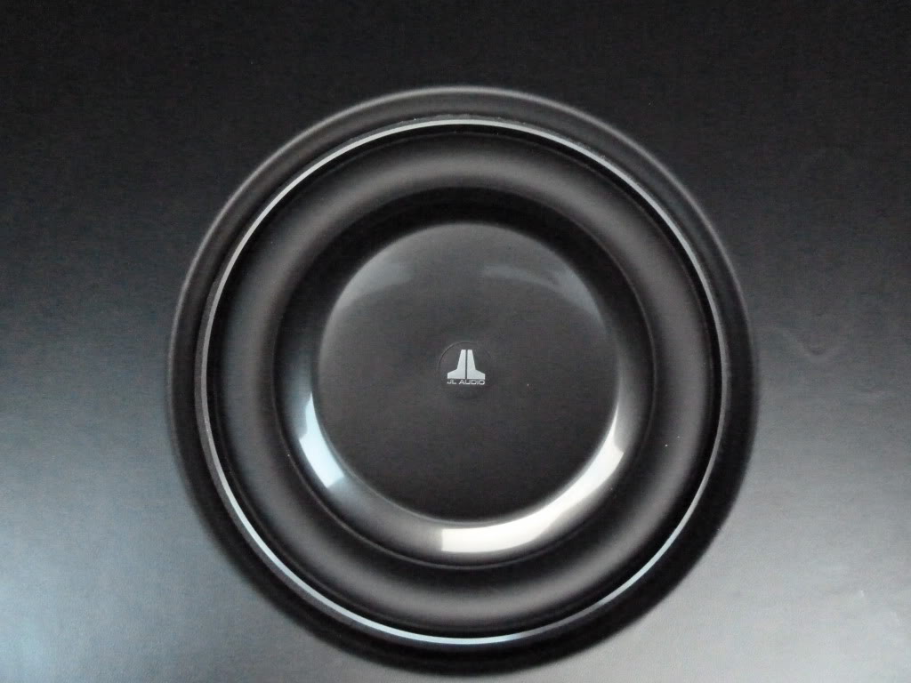

Sounds really good, JL 13TW5-3 w/ a sealed enclosure and an Alpine MRP-M1000.
