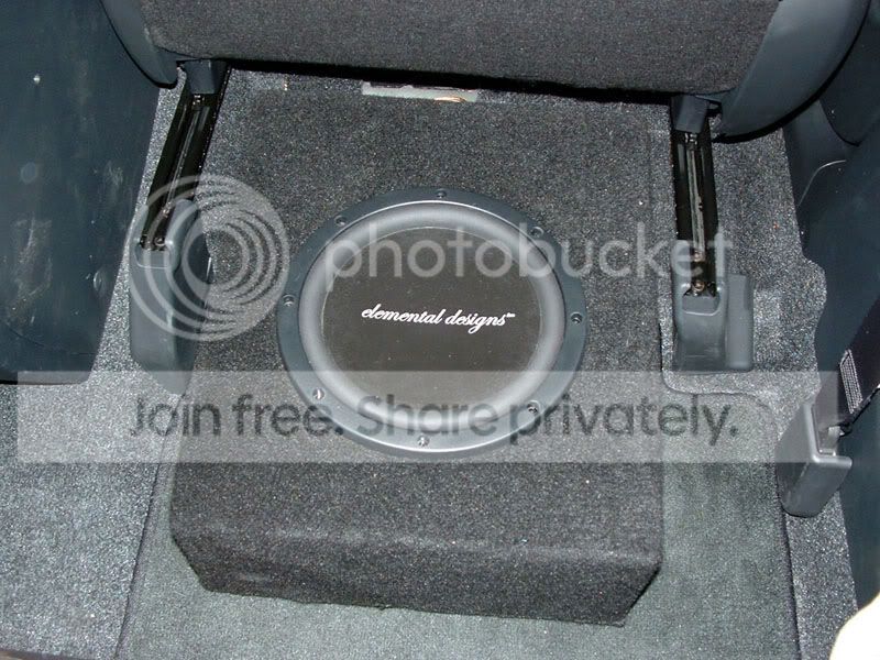

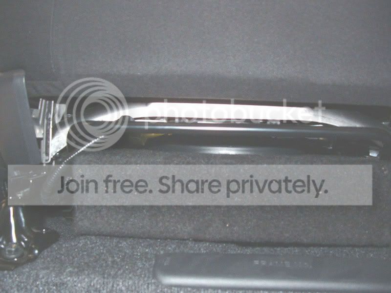

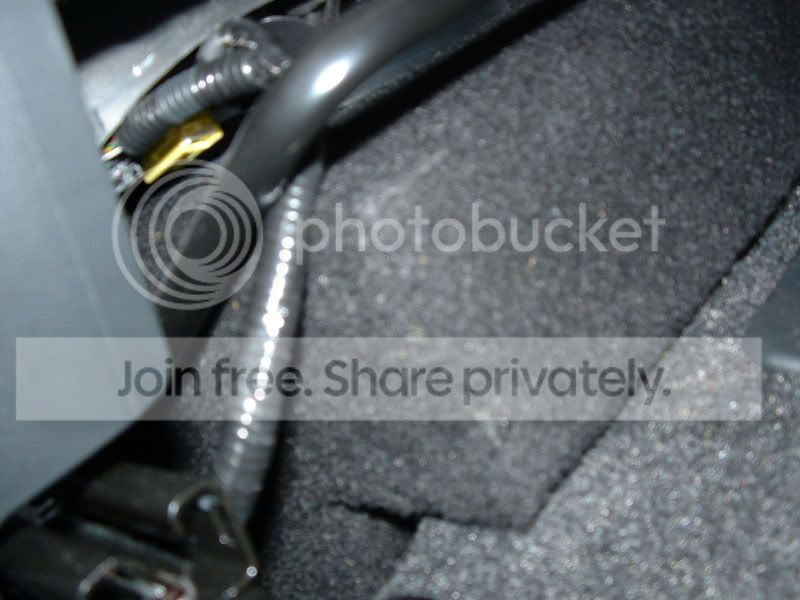

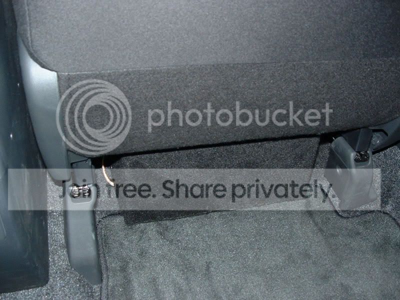

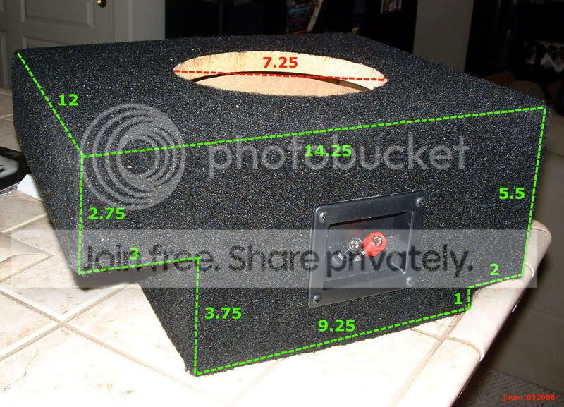

I posted a while back when I installed an 8" Premier slim sub and enclosure. It was nice but didn't sound as big as I wanted. I also used 2 10" CDT MS100 subs for a while. Of course those sounded best but it took up too much trunk space. I wanted a stealth installation that sounded like a big box. I scored an unused eD 9kv.2 8" woofer on ebay for $50. I tested it in a 0.3 cu ft box and the little thing sounded great - much like a 10" woofer. So I designed a box to fit under the passenger seat that would be ideal for the 9kv.2 and fit perfectly. I sent the design to eD and had them build it. Cost was about $85 plus shipping. It took longer than I wanted but it's here and I'm happy. The finished product is 0.31 cu ft and does not protrude into the passenger foot space. There are 2 things you must do in order for this box to work. First you have to cut off the portion of the floor vent that sticks out into the floor space. You also have to relocate the sensor that hangs down from the passenger seat. It was simply moved above the bracket and the bracket was bent up to clear the way. It's a tight fit with about 1/4" side clearance between the seat rails and maybe 1/2" (or less) of clearance above the woofer. I tested many loud songs and there are no problems with excursion. The seat can also move front-back without bumping into anything.

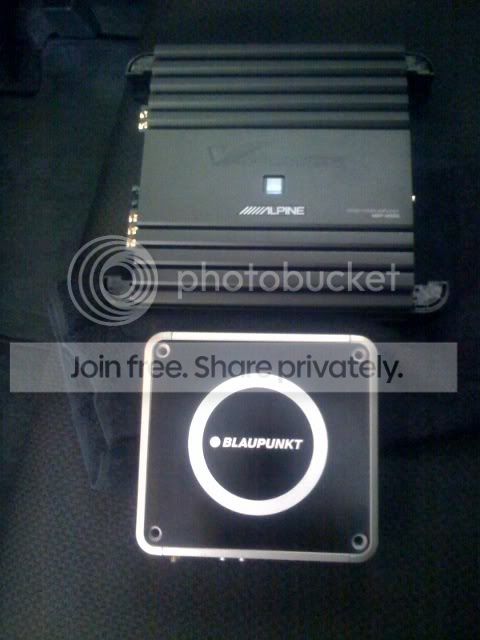

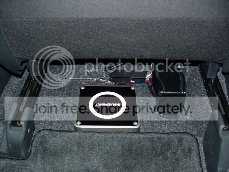

old amp under driver's seat.
new Alpine 300 watt mono amp to replace the old Blaupunkt - much better! Also under driver's seat. This amp fits very snuggly in between the 2 humps on the floor.
Feel free to use this design for yourself if you're interested. A great thing about having a sub up front as opposed to the trunk is that it sounds ideal in ALL seats. I usually find that trunk-mounted subs sound boomy in the rear seats when the front is balanced. And the bass is weak up front if the rear is balanced.
btw, the amp is putting out 190 watts RMS. It's a Blaupunkt THA275PnP . It's hooked up with a LOC tapped into the rear speakers. Main speakers are Polk db6501 up front and db651 in the rear powered off of the head unit. The whole package sounds great and gets decently loud. ...and I got my trunk space back.

Thanks. ...and I did not build the box. just took all the measurements and designed it. I had the nice folks over at Elemental Designs build it for me.

Anyway, I'm loving the new enclosure. It's got all the punch the old 8" had and then some! ...and it can get lower. It's got plenty of headroom to match up with the main speakers too. I was able to bring the amp into 'protect' mode, but it was waaay louder than it should have been.

It's all in the original post my friend. Then Post #4 sums it up in 1 sentence. I even have a picture of the box I designed and am basically giving the design to anybody who wants to use it.

Yes, 2 9K's. I've got all the materials including 5-minute epoxy for securing the PVC to the MDF. The boxes should be 0.41cf sealed. I need to get the xB into the garage to do the final measuring on both sides and do the math. I'm fairly certain I can make it fit under the drivers seat, I just need to determine if I need to relocate the sensor. As I said, my goal is to create one design that'll work under either seat. As the driver's sensor is bolted, it's the passenger side that's probably going to be the biggest obstacle. In the end, I think the sensor will be mounted elsewhere on both, but we'll see shortly.
I forgot to mention earlier, great design and box, Rock. The dimensions on the pic are great for anyone wanting to build it. Very clear.
I calc'd the interior volume to be 0.32cf. Is that right Rock? I just wanted to include that for reference in case someone wants to build your box for another sub (there are plenty of 6" or 8" subs out there that this would work for.)
