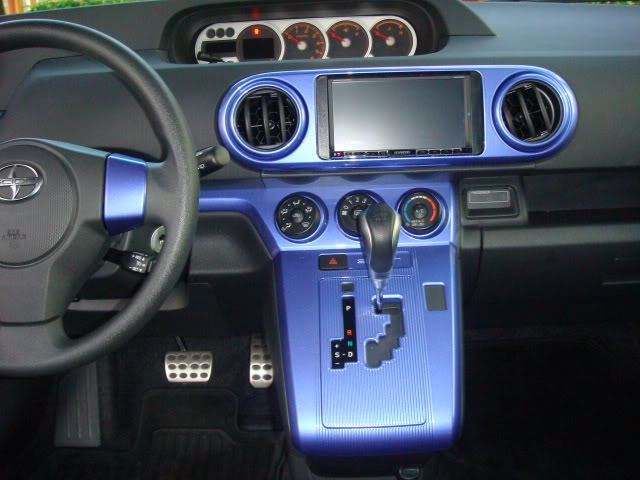

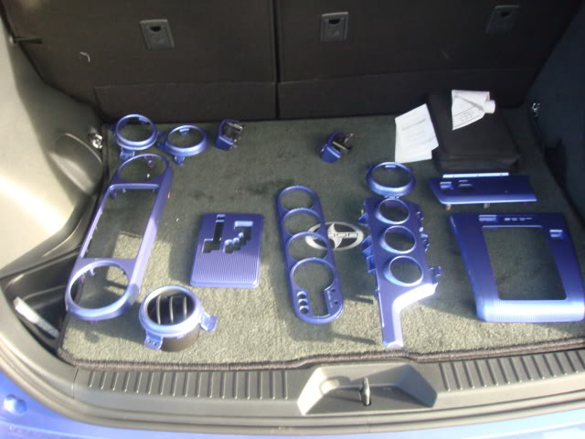

I will post pics soonName:  DSC02864.jpg

hey wait.. how the hell did you get the stearing wheel peices off.. thats great!!! please help

Originally Posted by Rs7.0
Looks amazing -- nice job ! (I'm missing the instrument panel though !)

Hey rs, u paint them urself ? I can't see the inside of the RS being any color than color matched to the outside looks sick man.

That really looks good. I'm impressed.My RS6 would be all red, so that wouldn't work for me, but I do like the purple for the RS7. Great job.

Thanks all, The instrument cluster was painted but not installed yet. the one that is not painted on my car is my spare one. I have the original one on my tool box waiting to do an led swap!
