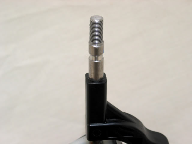

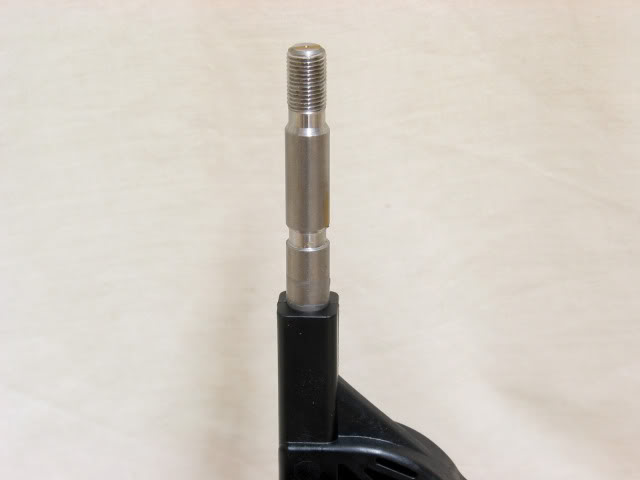

I recently decided I wanted to reduce my manual transmission shift throw, but in researching the transmission mounted TRD Quick Shifter, I decided it wasn't a good choice for me (reports of notchiness and other shift issues). Since I have no problems with my OE shift mechanism, I finally decided to shorten the shift lever by about 3/4".
(original)
(shortened by about 3/4")

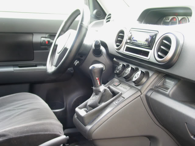

I could have dropped the **** by 1", but I found 3/4" worked better for me personally so I added a couple nylon spacers.
(raised by 1/4" from maximum drop)
The result is a much shorter shift throw and a much more comfortable reach to the ****. Looks sportier too ! Personally, I'm very pleased with it.
