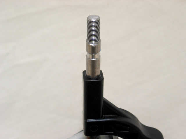

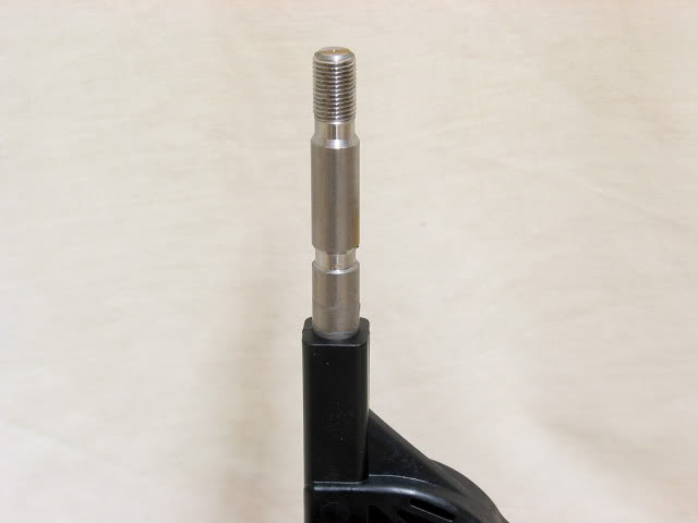

Only problem is having a tap and die set isn't enough. You also have to reduce the shoulder to the point that the die will fit, and that's a fair amount of metal to remove. Further, the reduced metal has to be appropriately round and concentric.
But, if that worked out OK, then good for you. How's the result with the TRD Quickshifter?
