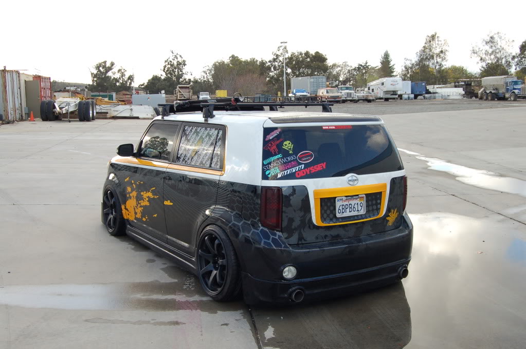

Im not running a muffler im just running the scuba with no pre-cat.
Essentially my set-up is:
Weapon-r header
Custom 3 inch down pipe
stock scuba with widened 3 inch ports
mandrill bent Gibson 3 inch tubing
Gibson 3" round stamped inter cooled tips.
