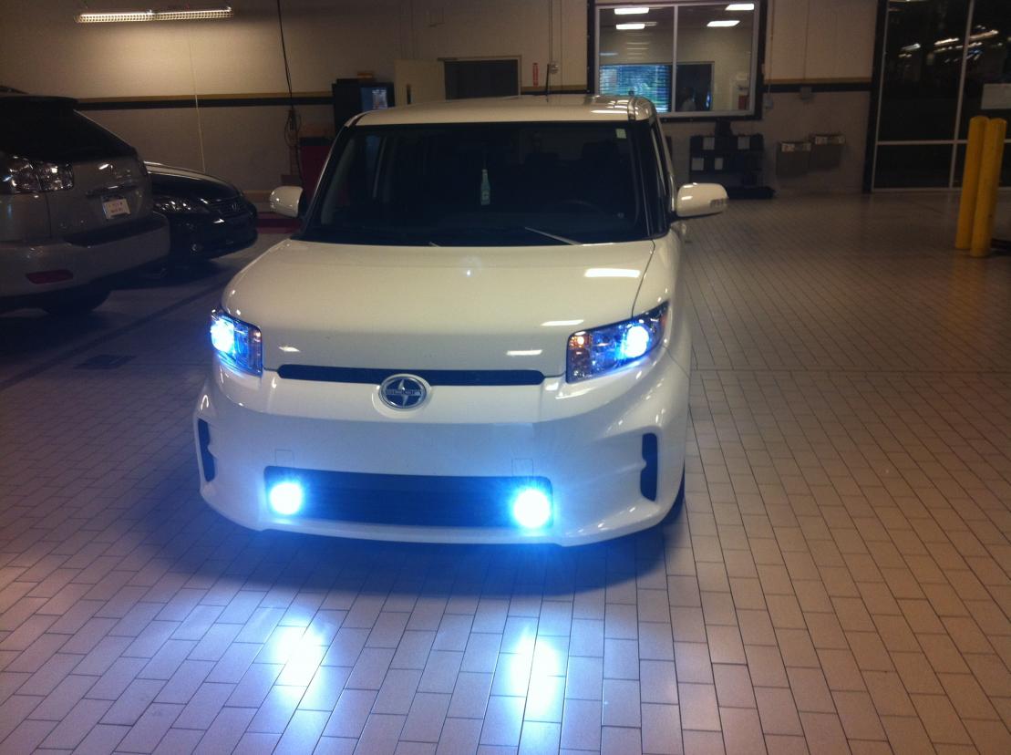

Hey guys. I haven't had time to be on here lately but I did get the HIDs in my fog lights. Here are the pics.
Attached Thumbnails Factory Fog Light Mod-058.jpg   Factory Fog Light Mod-059.jpg

Fast Question, What size are the fog light bulbs? i need to order new HID bulbs but forgot what size
Old Aug 11, 2012 | 01:57 AM
Lele73's Avatar
Joined: Mar 2011
Posts: 81
I was told they might be H11 bulbs for the fogs... can anyone verify?
H11

Originally Posted by lefty29er
H11
thanks
