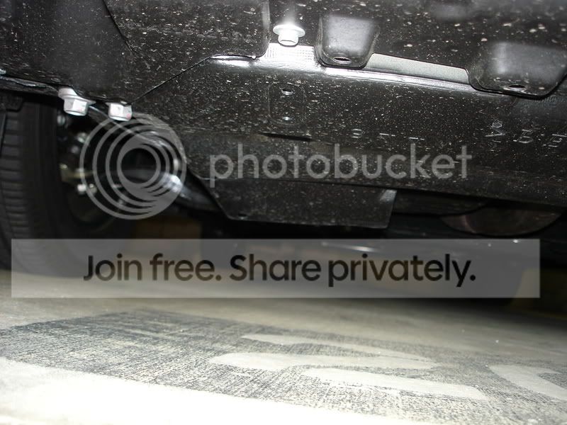

i accidently went over the curb(brick) that's placed front of the parking lot. when i reversed, i heard something rip under the car. i went outside and looked undereath the car to find out, a plastic panel on passenger-side below front bumper is hang loose. it looks like a plastic tap came off, but i also see a cut... i wonder if i plastic piece ripped off??? anyone have service manual or picture of the part under the car so i know i didn't rip off the panel...

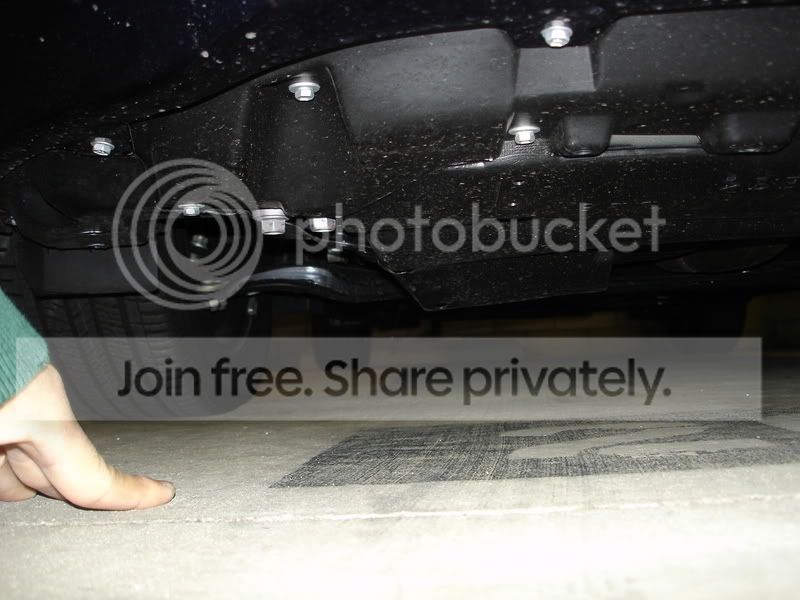

anybody have or find a picture of undereath the front bumper?
Old Feb 21, 2008 | 05:40 AM
sdsnybny's Avatar
Posts: 1,679
From: Auburn, WA
try this...
take a picture of the other side (non damaged) and flip the photo inside out in your photo shop and it will look like the side that is damaged

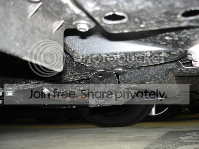

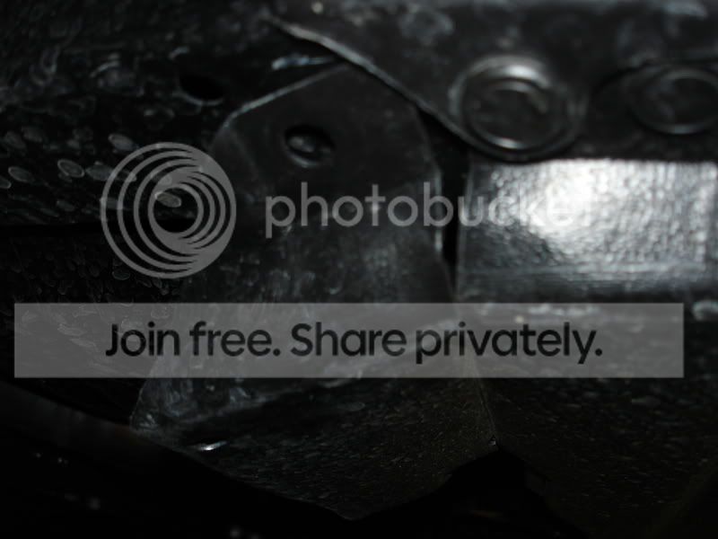

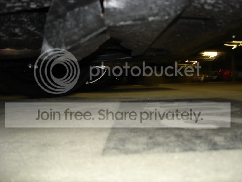

fawk!! i took off the front plate bracket to find out that bastards at the dealer drilled a hole on the bumper to mount the bracket... ~~!!!!! fawk~!!!
here is the pix.. it looks like it's ripped.. i asked the dealer the replacement and they said it's going to be $120.... damn bastards..

no big deal that it's ripped.. is it missiong a mounting push in fastner, or did it pop off the fastner to the right of the rip?
if it poped off the push in fastner, just get a small bladed screw driver under the inner groove and pop it out of it's seat, remove the fastner and seat, then just line everything up and put the seat and fastner in..
if there is supposed to be another fastner (looks like there may be a hole in the metal there) just go to the "fastner" section of you local home improvement store, and get a new fastner for like a buck.. or go to the dealer and get one for a few bucks..
it looks to me like it just needs to be straightened out and re-attached is all..
did you look at the other side to see how it's connected there? it's a real easy fix.

so it's ripped??? it's ripped pretty clean, i can't tell if normal for that plastic to bend or it's due to the cut...

even if it's ripped it aint that bad.. push the bend a little bit, it will pop back into form, you can always get some black duct tape and put a strip over the rip, but to me it doesn;t look ripped, it just looks like the fastner popped off and the end is hanging.. you just have to wait till it's dry outside, and get under it and look at it, see how the other side is fastned, etc...
