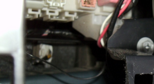

She loves it and we got a very good deal on it, but there's one thing that I'm puzzled about. It looks like an aftermarket mod - an on/off toggle switch next to the TCS switch.
I pulled off the panel and found two wires - one to ground and another (to I can't tell where) that's been cut.
I don't expect anybody to tell me "Oh, that's easy it's a..." but I am hoping that you might be able to point me in the right direction to gather further info to help figure out what it is.
Here are some pics and I'd be very grateful for any thoughts that you might have. The last one may be the most useful, since it shows the direction that the cut wire heads off in, after the switch.

Might have had some aftermarket lighting. Have you traced the wire as far as possible?

But in seriousness the 2 wires are cut so there is no use for them. Nothing will happen. More than likely was some form of lighting. I put a switch for my amp there to turn them on and off.

To answer the questions, there doesn't appear to be any aftermarket lighting fitted and the last pic is as far as I've traced it - not very far at all. I'll try to trace it further when I get a chance.
I'd thought about a Flux Capacitor, but couldn't see any sign of one. An amp is a possibility that hadn't occurred to me, though and it's a bit reassuring because I had a nagging fear in the back of my mind that it might have been for a Nitro injector!

It also could have been some kinda ground for an aftermarket stereo to bypass the parking break... possibly.

That's a simple toggle switch. If one side is to ground then it sent ground to something else. The most common thing would be to the parking brake wire on an indash unit to activate the video while driving. I would just pick up a a blank from ebay or the dealer and replace it unless you plan on using it for something else.
