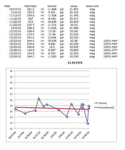

I just got back from a long trip and averaged 22-23 mpg going around 72 mph the whole way. On my trip, i was in a big city with a lot of lights and there I got 17 mpg!!!
I am posting all of my fillup data going back to October. I got my wiring harness replaced (CEL lights were on) mid November and changed my plugs and cleaned my MAF mid-december. I also put in Techtron several fillups ago. My tire pressure is at recommended and my air filter is clean.
I ran into a guy with the same xB as mine (RS 5) and his is stock like mine except he has the standard wheel package instead of the 19" TDRs like I have. He said he gets 29 pretty regularly but he commutes about 45 minutes to and from work each day.
Considering his as a baseline (drives in same state with same winter fuel blend and i just did a lot of hwy driving) do i have an issue or is there anyway that my wheels can be dropping my mpg by 6-7?
EDIT: I just read on clubxb.com that the stock tire and wheel combo weighs 41 lbs per wheel and the 19" TRD's tire and wheel weigh 31.5 lbs so I'm thinking this is NOT my issue. If anything I should be better than stock.
I have yet to change the fuel filter. It could be the original with 40k on it and I plan to do that today
EDIT: Advanced just told me that the fuel filter is in-line with the fuel pump and therefore not serviceable like it was on my old honda civic.
If I take it to the stealership, what can they check/change/replace for me that would make it worth their $100/hour rate. What about getting the injectors cleaned? Am I freaking out over nothing?
I have a 2008 Scion xB AT with Strup Header and TRD Cold-Air Intake, 55k miles.
Bold One: The lights always kill you. My city is the largest in the U.S. land-wise, and in certain parts, there's tons of lights that will devastate my MPG. Try coasting more and tapping your brake less. When I'm feeling conservative, I drive this way.
Bold Two: The problem is this other guy is commuting 45 minutes, and is most likely driving on freeways and interstates more than you are. Not to mention, probably doing a safer speed. When I used to commute the same for my job, I coasted on I-95 at 66mph and achieved impressive fuel economy. Since I don't have that commute anymore, my mileage went down because I'm not on the freeway.
Bold Three: You definitely have the right to be concerned, because I lost a lot of my fuel efficiency, but most of it is because I have that header in now.
For my circumstances, I drive 80% city/20% highway. My average is around 23-25. It used to be in the 26-27 before my header was installed. I'm not as concerned with this slight drop because now that I have that speed gain, I can accelerate faster and avoid bad drivers in particular circumstances (which is common in Florida).
As for your 18mpg city, I'm not sure what that's about because I never get that low. I can only suspect that it's your driving habits causing that. There are times when I am for spirited driving, but when I'm in the city, I'm always coasting or cruising. I try not to ever hit my brakes unless I am forced to.
The best way to do this is to stop acting like you're in a hurry, because I've learned that saving a measly 2 seconds is meaningless. So I gap myself at least 1.5 cars away from people when I'm following. This allows me the opportunity to coast more rather than tapping on my brakes and losing momentum.

Thanks for the input. I hear what you are saying on the driving habits. but i definitely feel this is not what is causing my issue. I use cruise control when I can and I also try to avoid excessive breaking. In fact, now that I have been monitoring my mpg regularly, I would say I am babying it even more. But this is where my concern is coming from, I've owned this car for a year and a half now and have just recently noticed this decline in my fuel economy. My driving habits haven't changed enough to justify this large of a drop in mpg.
What I am looking for is what could be causing this mechanically. I am hoping someone will chime in who has had a similar issue and can recommend what I should tell the dealership to check for. I can't help but feel this is all related to my engine wiring harness which went bad and had to be replaced. But I can't figure what has been affected and could be causing this.
