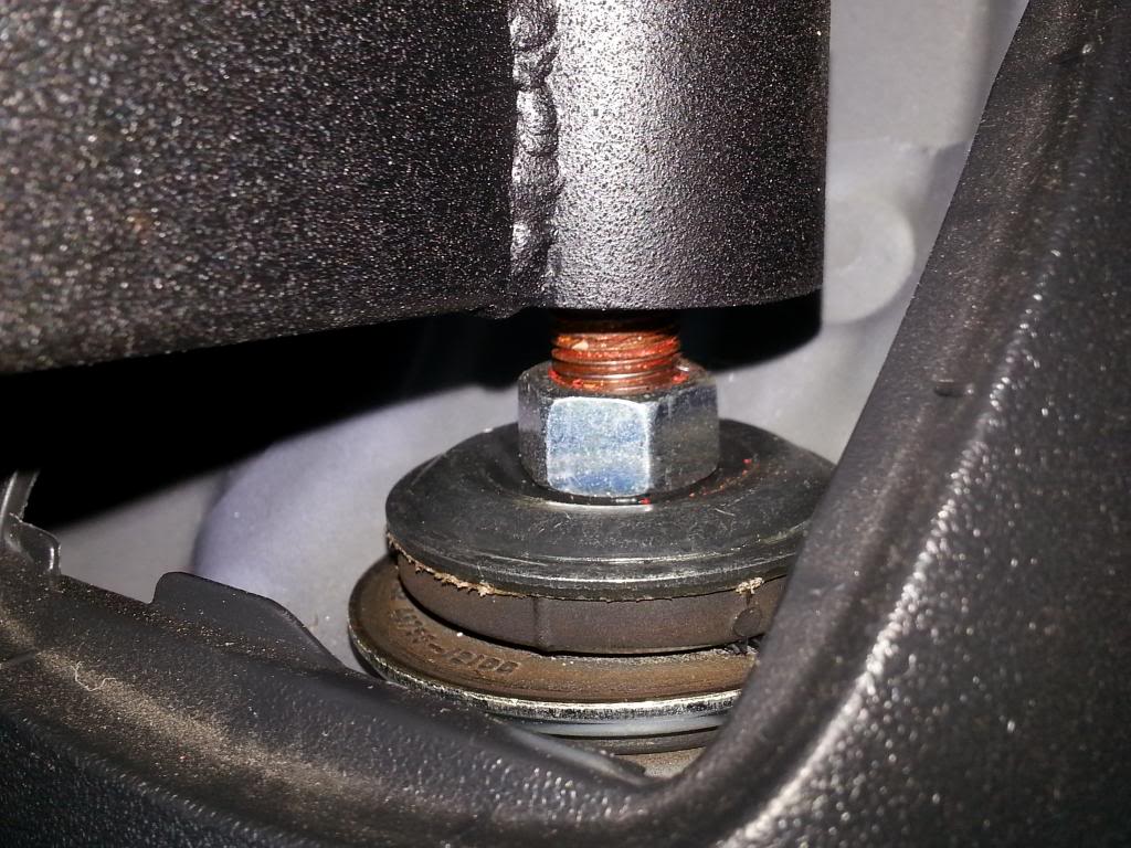

I bought this product thinking it was something nice. I am not happy with this product at all. The trunk brace is hollow flat stock not tubular, the welds are not that great and the mounting holes are not even. Plus is won't fit without me trying to force it. The traction bar i received is bent and not fully welded also hollow flat stock, and the cups are not even. The Mid brace is not that bad but it looks like a lot of spot welds instead of a solid weld. I contacted the company and they do reply fast. They say it is a no return policy which i don't see on there website, also they want me to pay shipping to send the defective traction bar back, packaging is very bad, not worth the money for the braces. Some of the reviews i read were good, but i am going to dispute this order because of bad quality of product and not receiving what was pictured. Ordered 2/17/13 received on 3/18/13. I can post pictures if any one wants. Also i have not installed any of these products i went to test fit the trunk brace and it doesn't even line up. I will keep everyone updated.

Okay i tell you what, if this ends up the way i think it will and i get stuck with these braces, before i throw them away, i will bend the trunk brace over my knee take pictures and post it if you want, you are really stuck on this statement, i was not exaggerating that statement. But the whole purpose of my post was to show my experience and warn others. No Returns even though its not listed, you must pay to ship back defective parts even if thats how you received them, you may not receive what is pictured, some fitment is required, so not fully bolt on then, and in my opinion the welding is not what i expected from a company that makes braces. I did want these braces, i read how everyone was happy with there purchase, well what i got is not what i paid for. I will be adding another chassis brace thru tanabe, i did want a trunk brace but not what i was sent. The company respond to every one of my emails in a very timely fashion, but again, i was sent a brace that was not pictured, the traction bar was not finished and put built wrong, the midbrace looks okay but i don't like the spot welds, and there are pieces of metal inside of it rattling around. I hear a lot of you have good luck with TB performance, thats what made me order the whole kit, but I got a raw deal and will not promote or support them.

So here are some pics of the trunk brace, shocks leaned in and tightened down and sound slight pounding to get it down this far, threads on my shocks are scared very little. I got one side very close to the nut, but the other has a way to go. About another 1" on one side and at least 2" on the other. Like i said i can make it work with a file and a hammer, 1/8" out of each side, shocks would be straight up and down and brace would be flat. TB also sends this brace with two nuts and i dont know why. I wanted a tubular brace with the ends notched to match and welded clean. I am no longer interested in getting replacement for the traction bar or using this braces.
