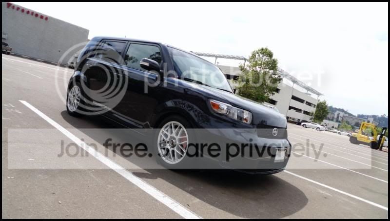

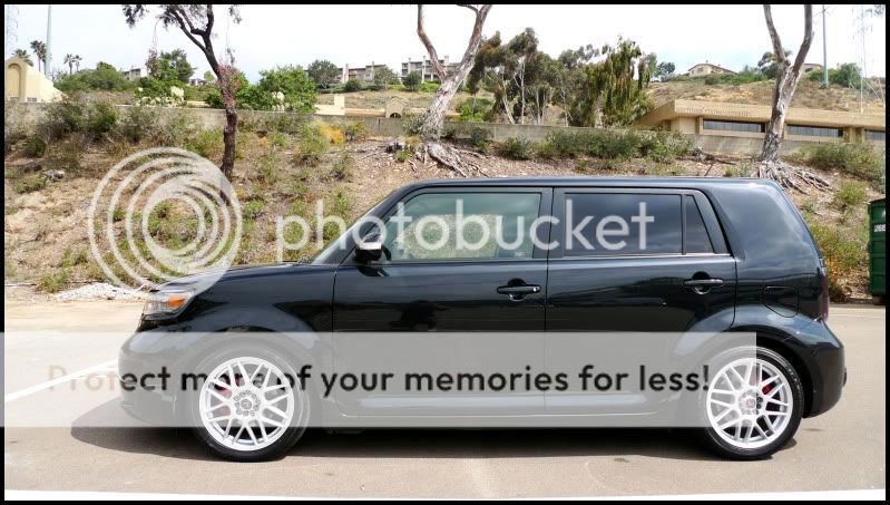

Looks:

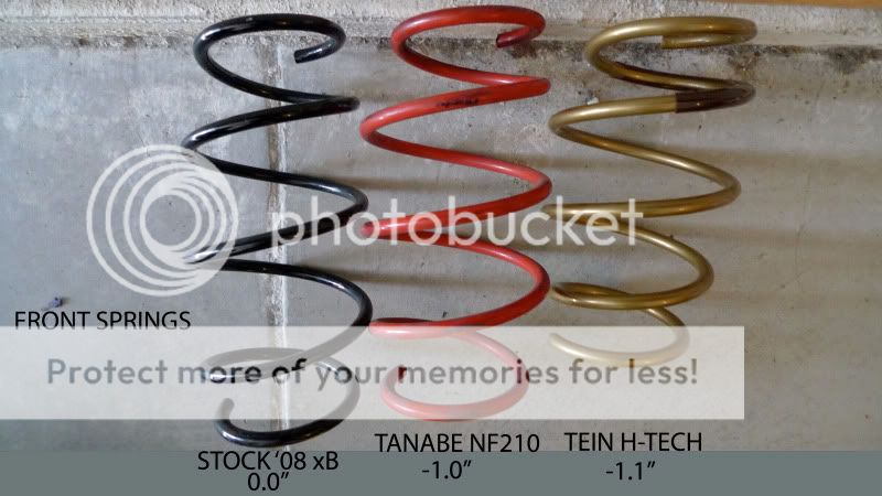

After 2 days of settling and about 60 miles, I have gained an additional 1/2" in front compared to the NF210s and an additional 1/4" in the rear. If I compare what I got compared to CIONIDE's stock measurements, then the H-Techs provide the drop as advertised in the rear, and an additional 0.4" out front. It's hard to say since I don' t have the stock measurements for my car. But I think my NFs were on the low side compared to others'. Here are my official measurements on flat ground (205/50/17 tires 35psi front/32psi rear).
From the floor to the top of the wheel arch:
Front: 25"
Rear: 26"

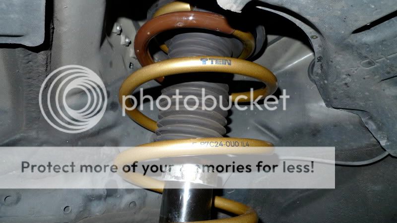

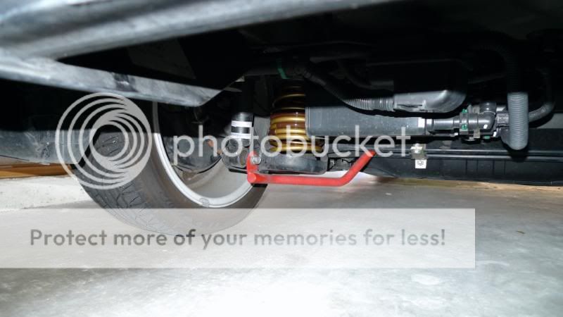

From the feel of things I think the H-Techs ride both softer AND stiffer than the NFs did. How did they achieve this? Take a look at the rear springs. Notice how the H-techs have about twice as much soft travel as the NFs do. that gives a really nice compliant ride. According to the specs, the H-techs have a stiffer spring rate. This is where the improved handling comes from. Notice how much shorter the front springs are. They are more than 1/2" shorter than the NFs when unsprung, yet the achieved drop is bout 1/2" more when on the car. The H-techs are definitely stiffer out front. With the front end being the heaviest part of the car, I think it doesn't really hurt the ride quality too much. The rear end of the car is what can be a little squirrelly in my opinion, and I think the H-techs do a superior job of taming that.
Another note is that I was finally able to get the rear end level on both sides. Many people have noticed that the right side rear is 1/4" higher than the left side. My H-techs were similar too, but I did some trial and error testing to try and remedy that. I jacked the car up with both rear wheels off the ground and twisted the right spring a little bit. The TRD installation instructions most of us go by say to index both right and left springs in the same orientation to ensure an equal ride height on both sides. Well, that doesn't seem to be the case. So I put on some grippy rubber gloves and gave the right spring a twist. Be sure to make sure the rubber spring seats are still on properly and not all mangled up. Then you put the car back down and measure. This actually took a couple tries but it was worth the effort. I always hated the fact that the sides were different. Of course, YMMV.
