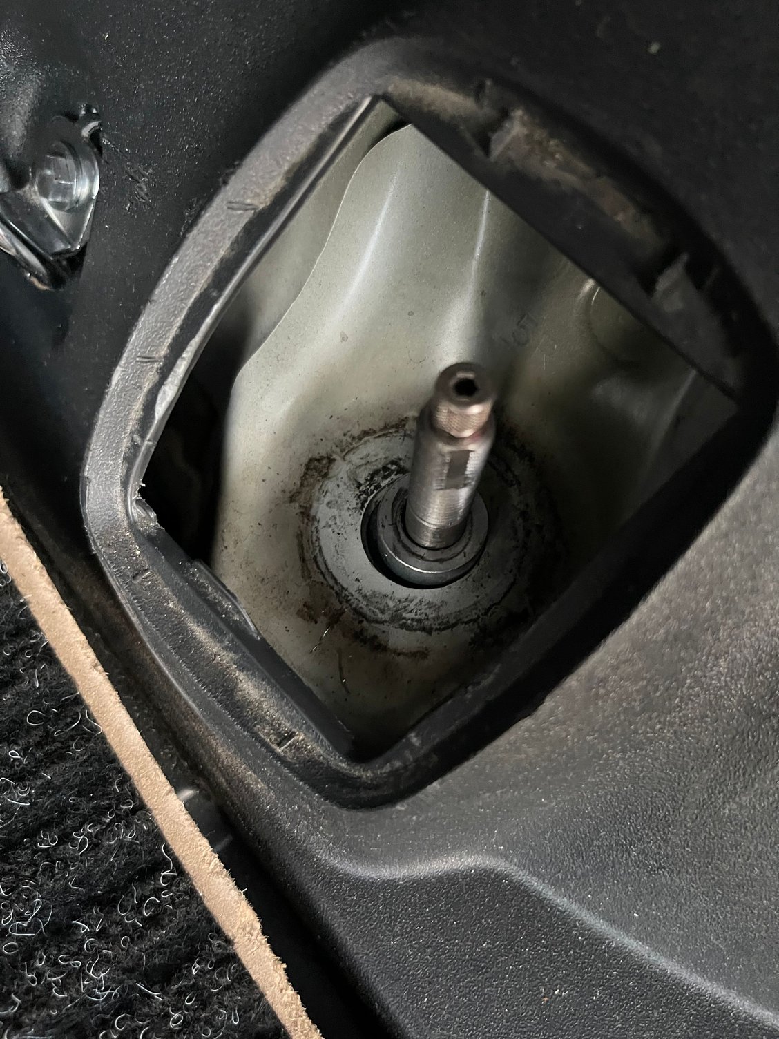

Not my first rodeo when it comes to installing suspension, even on cars with a separate spring/shock in the rear.
issue I’m having is after the rear shocks are installed, I’m hearing squeaks from the shock mount inside the hatch area. I eliminated this by loosening up the top nut and lubing the rubber bump just under the large metal washer.
The noise happened again, so I checked it out and while bouncing the rear, the top nut actually moved upward somehow. Everything is still tight so I’m not sure what is going on.

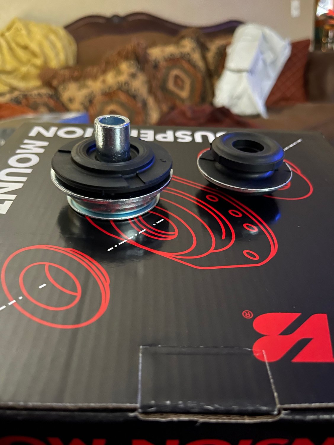

Got the parts. I think they’re supposed to be positioned as shown.

Flip that smaller top piece over so rubber goes over metal bushing of "dust cover". Then you've got rubber & rubber touching body of car and no noise. Finally flat-washer and nut on very top pushes on metal instead of rubber.

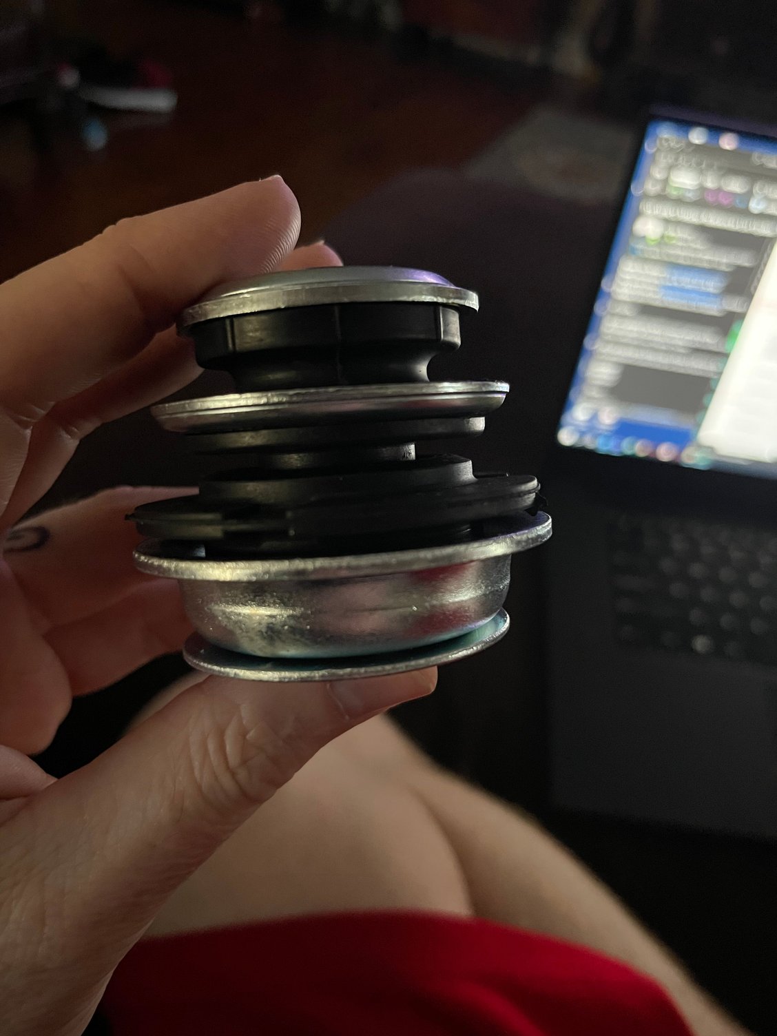

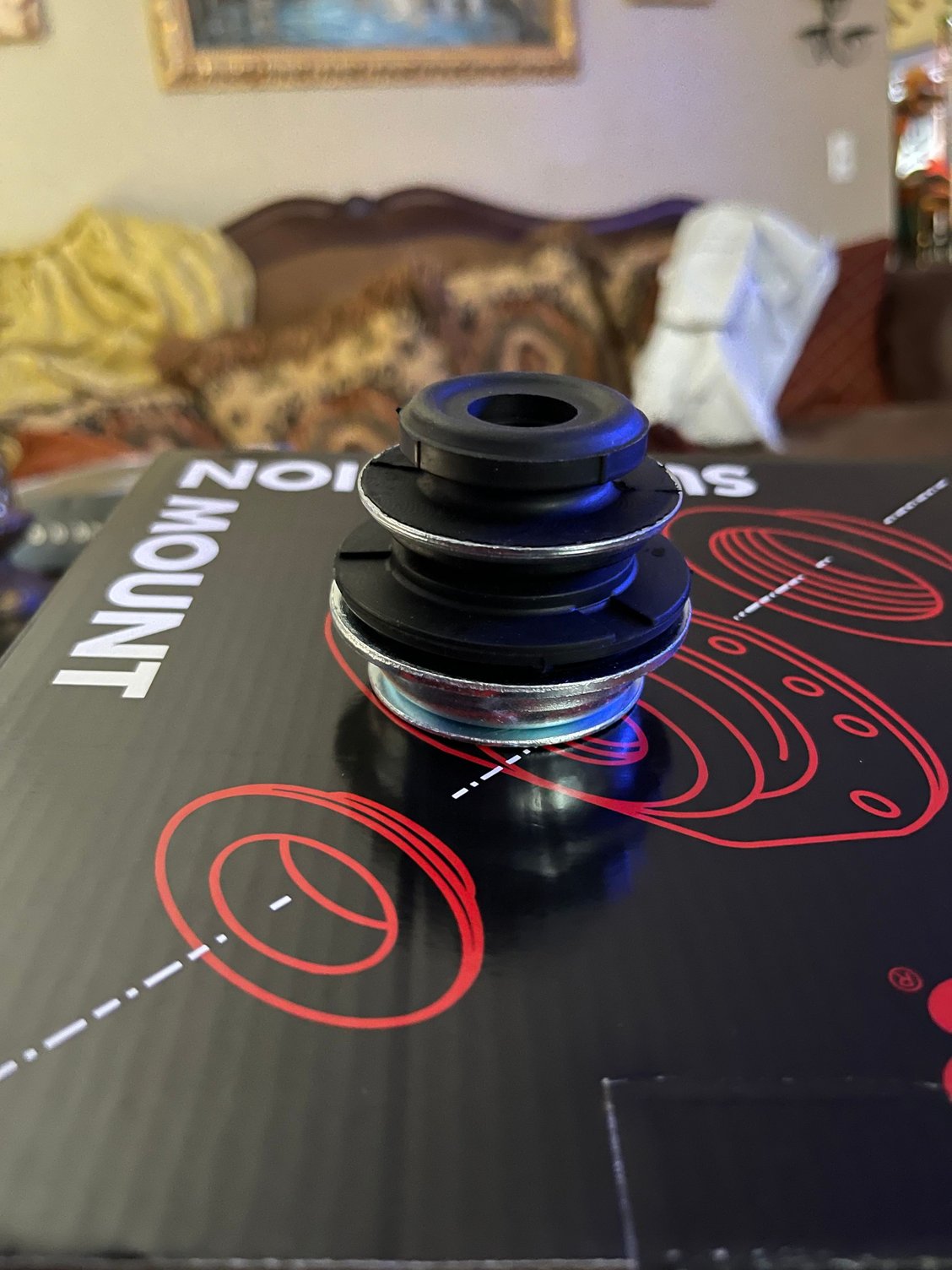

right now it is rubber to rubber. Here’s a better pic, and a washer that goes on top. Also, there’s no way to make the washer go metal to metal with anything.

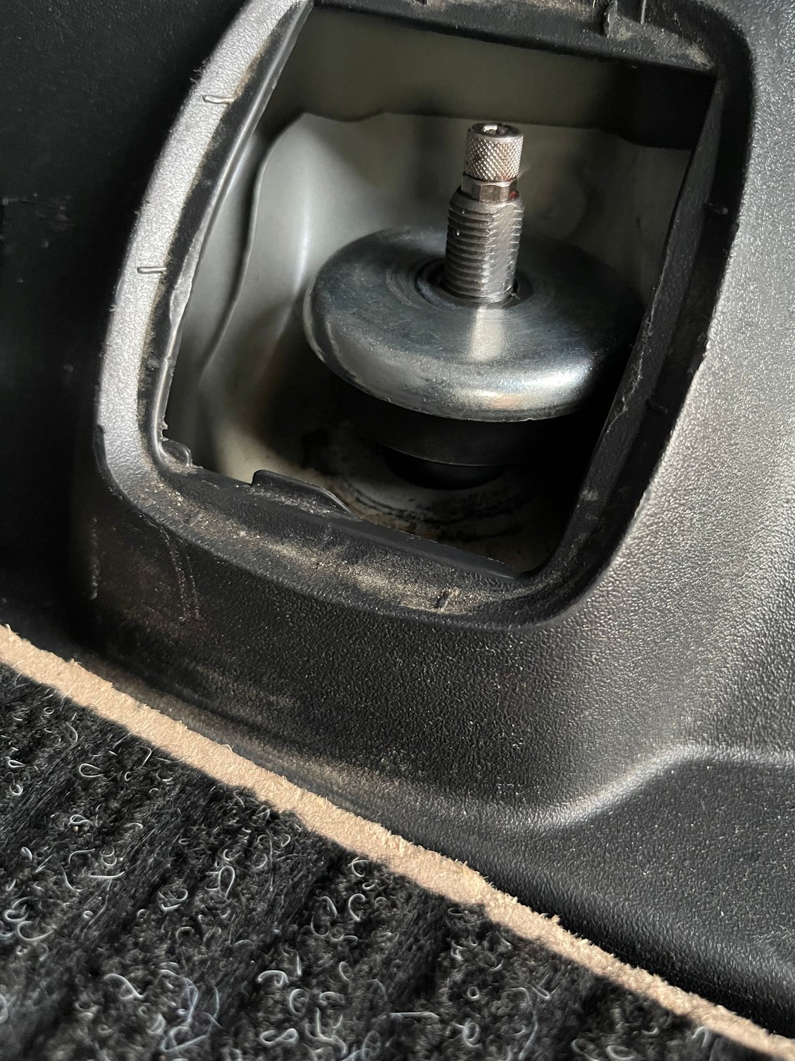

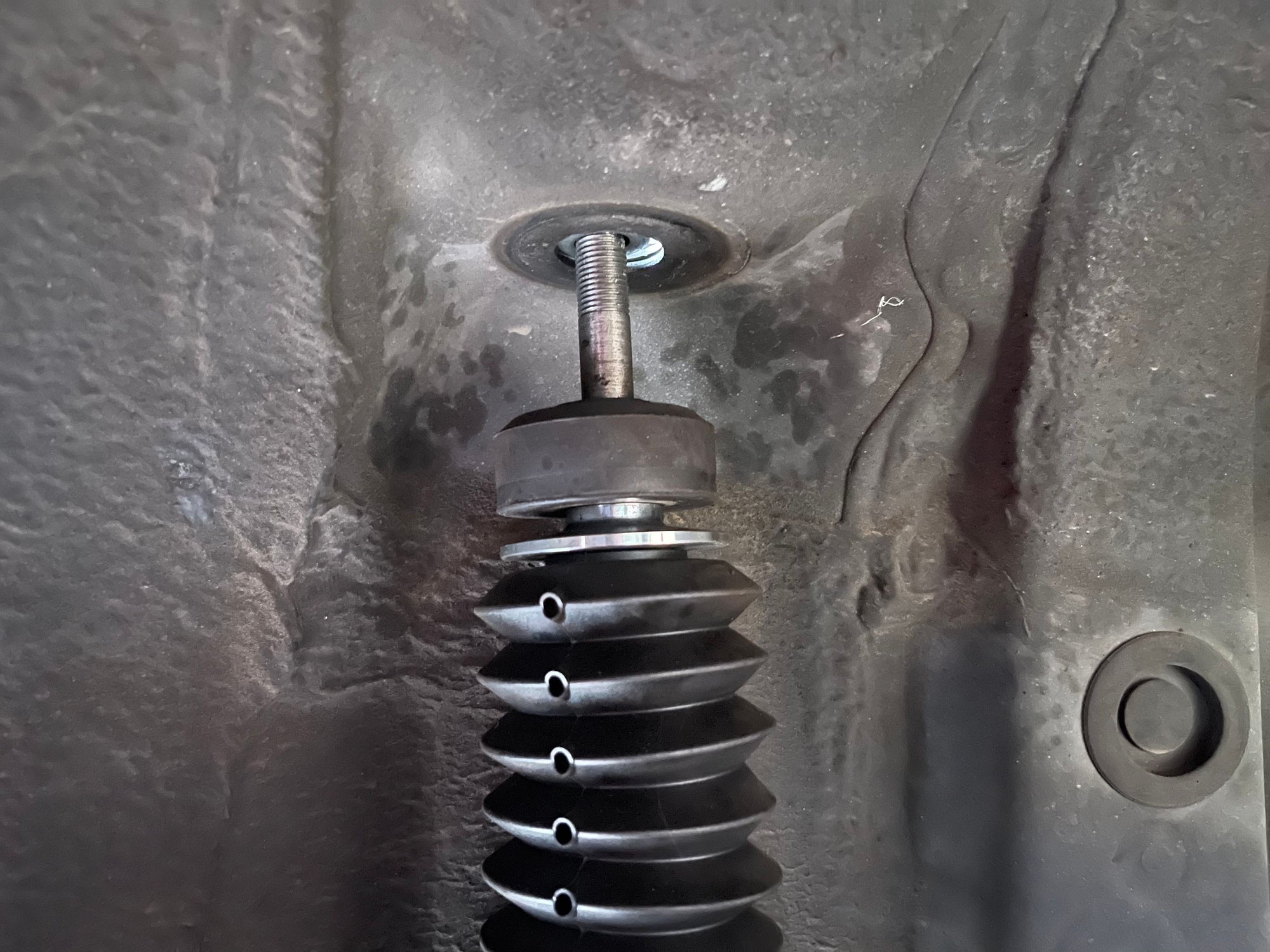

i installed everything and drove about 50 miles or so and started hearing a slight rattle coming from the rear. Noticed that on both rear shocks, if I push down on the car, I have about 1/4” of travel on the shock. What I mean is that the top nut and top washer are loose against each other.
when I tightened the stocks down, I had the car still jacked up. Maybe I should have done it with the car on the ground? Either way, there was no more tightening I could have done. Really not sure why there’s so much play back there. All mounts are correctly installed.
EDIT:
ok so it turns out I was tightened down to the bottom of the threaded portion of the shock, which left maybe 1/8” of space between top washer and nut.
Ended up getting like 1/2” worth of washers per side and it seems the problem is solved. Real test is tomorrow after my drive to work which includes some winding roads.
