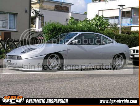

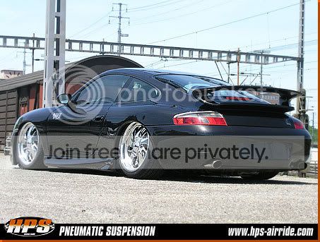

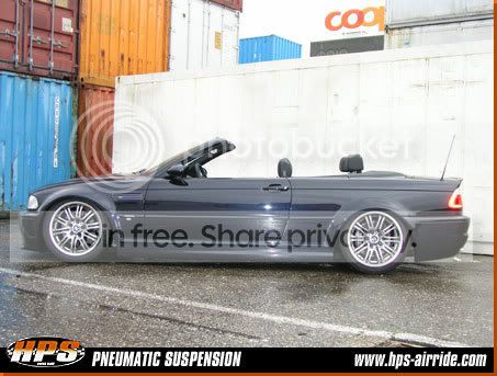

I have seen many of the cars you mentioned on air/coilover setups here are a few.
You are basing your opinion of air ride on the kits that are designed purley to make the car low for show purposes not an air ride suspension system designed to perform well and raise the car when needed. In the end it is you get what you pay for. If you spend money on a quality air ride suspension designed to perform well then you are going to get the best of both worlds.
