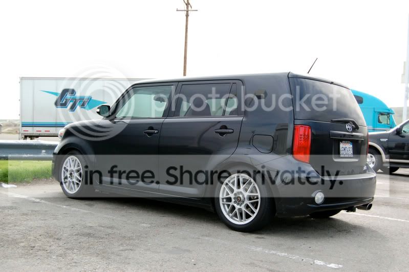

here is mine with 17x7 with a 225 45 17

Coryjames what were you dropped on this pic? Ksports? I am in the market for tires and def like the way yours looks. I am currently dropped on df210 and looking for a similar stance. I have 17x7 rims as well.
Old Mar 14, 2009 | 11:15 PM
coryjames's Avatar
Posts: 7,024
From: Arvada, CO
im ok ksports
