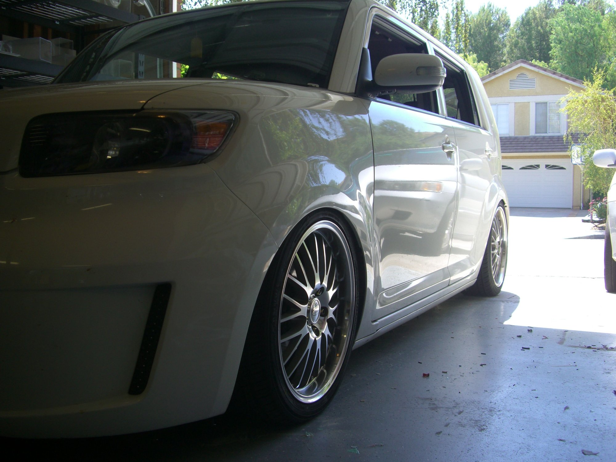

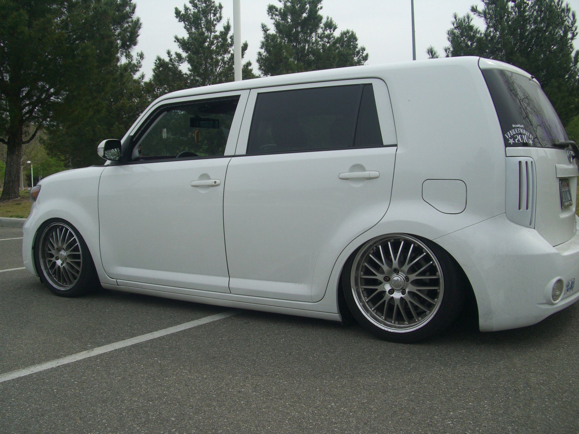

A lot will depend on how wide your wheel is and what look/clearances you have. I ran 18s I had 225/40s on an 18x8 +40 wheel for awhile and it was great. Eventually when I went to air I would rub at full drop and didn't want to roll my fenders so I went with a 215/40, it was just enough to clear all the way down. Definitely felt the road a bit more due to slightly less sidewall but more due to the stretch on the tire, where the 225s were a square setup. A lot will depend on what look you want and what wheels you have.
In the shots below the first shot is with the 215/40s while the second is with the 225/40s.
