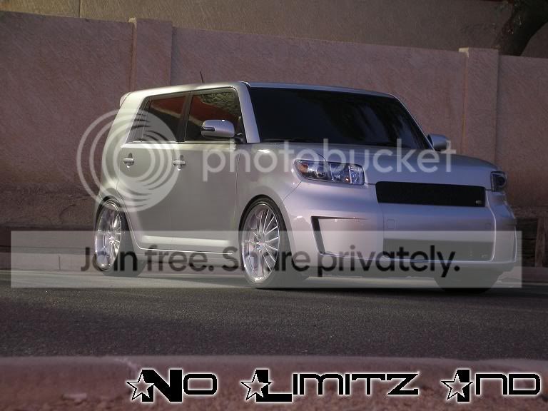

Here's what NoLimitzInd is running:
Concept One Wheels, 19x8.5 front +38 offest, 19x9.5 Rear +38 offset, , Hankook V104 Tires, 235-35-19 front, 245-35-19 rear
I don't think his fenders are rolled, but I'm not sure if he rubs. Keep in mind that he is also on Ksport coilovers.

no limits fenders are rolled i have a 8 in the rear with a +42 offset and i still rub and im even stretching a tire

Yes I am running a a 19x8.5 with a +38 up front and have no rubbing up there unless I hit a hard bump or big dip. Then it only hits the plastic inside. The rear I am running a 19x9.5 with a +38 and it does rub alittle. I have rolled the rear fenders for sure. It is not a big deal at all. I am pretty low for being on such wide wheels though too.

No limitz what size tires are u using...i plan on the same setup with the 19's 8.5 front and 9.5 rear. i'm on trd drop and am curious if i'll rub at all??? any help would b great. ps love the new tails, plan on getting mine soon.
Old Mar 29, 2008 | 03:06 PM
CIONIDE's Avatar
Posts: 6,012
From: Napa, CA
If you click on his user name it will take you to his profile, where all the info and specs on his xB mods are listed.
