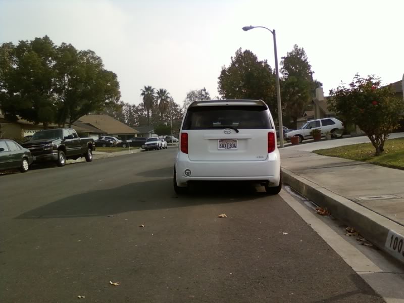

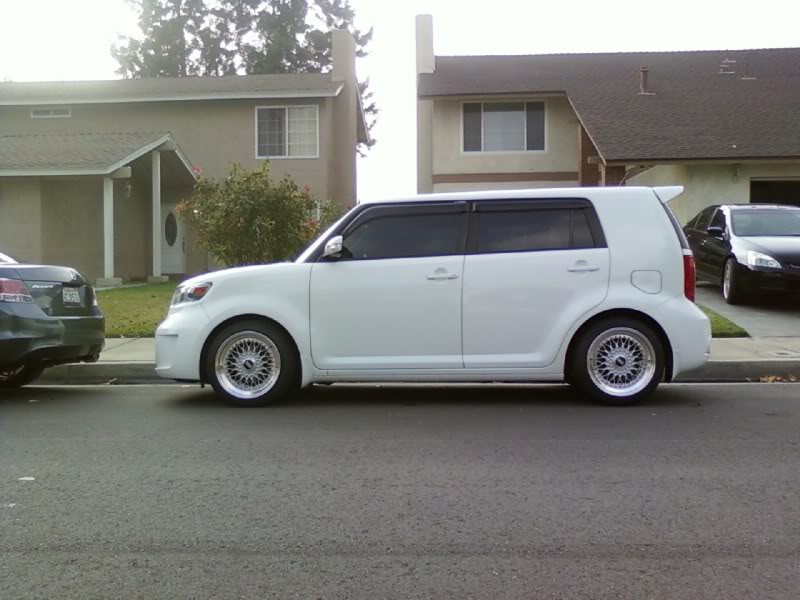

I'am on 17x9 bbs rs +19offset 215 45 17 nankangs stretched with a settled trd springs and it doesnt rub at all.
here's the pics

love the mud guards! your bbs' are def lookin great on your car!!

The BBS RS is my all time favorite wheel. Where did you find a set with the right bolt pattern? True 3 piece? I hear they made them in a less expensive one piece that looked the same.
