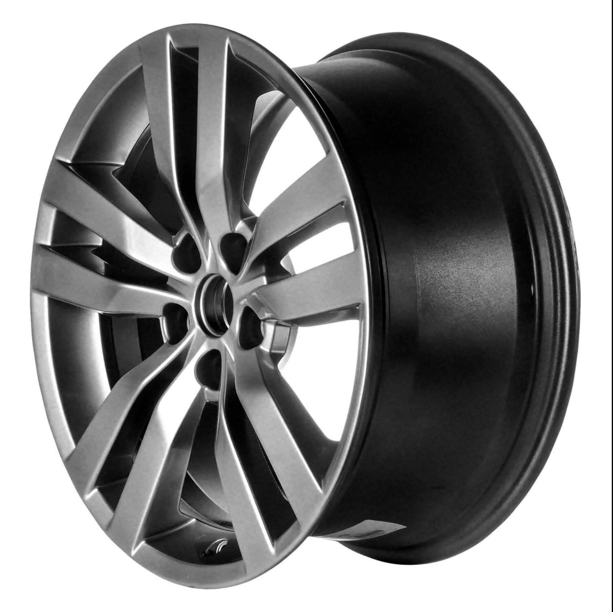

Has anyone tried installing Subaru rims on an XB? Just wondering if i would need any type of spacer for this rim. My other rim option is the 17’s from the Scion IM 2016.
SUBARU IMPREZA 2012-2017
Fitment: Front or Rear
Material: Alloy
Style: 10 Spoke
Finish: Charcoal
Bolt Pattern: 5x4.5 inch 5x114.3 mm
Offset: 55mm

Pretty sure the hub diameter for Subaru is smaller than Toyota/Scion so you would either need spacers or have to machine the hub hole on the wheel to fit. Double check what Subaru's hub diameter is. The xB is 60.1.
Actually, looking at the offset and width of the wheels you posted I would put a 15mm spacer on them anyway.
